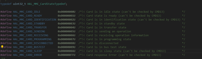

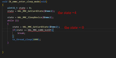

STM32U585 + eMMC , by SDMMC2 bus
I want to configure the eMMC into sleep mode by HAL_MMC_SleepDevice API,but It does not work
It alway return 0 when I get the card state by HAL_MMC_GetCardState after run the API HAL_MMC_SleepDevice.
Thanks!

Hi dylanou,
Did you solve this problem?  I'm seeing the same behavior and not finding the accepted solution especially helpful.
The HAL_MMC_SleepDevice command is not returning any errors, and the state changes are exactly as you show in your post.  Within the sleepDevice command there is a sleep_timeout field that I don't completely understand.  Does the solution have to do with disabling this timeout?
Thanks for any help,
Steve
