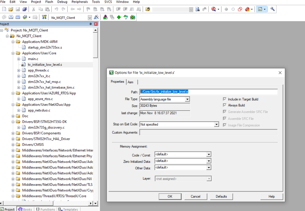

From the errors in the screenshot, it seems like you don't compile the files:
Middlewares\ThreadX\RTOS\ThreadX\Core\tx_thread_schedule.s
Application\User\Core\tx_initialize_low_level.s
Middlewares\ThreadX\RTOS\ThreadX\Core\tx_thread_stack_build.s
And maybe other assembly files.

Sorry for the incorrect paths, I blindly copied them from the IAR map file... But they are not the actual ones:
so for IAR tx_thread_schedule.s and tx_thread_stack_build.s are in:
\Middlewares\ST\threadx\ports\cortex_m7\iar\src
But I think you guessed it already.
>> there seems to be a batch file for compiling this stuff... can you ask the CubeMx team to fix this issue... for the MDK-ARM solution ?
Keil uses the files in \Middlewares\ST\threadx\ports\cortex_m7\ac6 folder (please check screenshot if that helps).

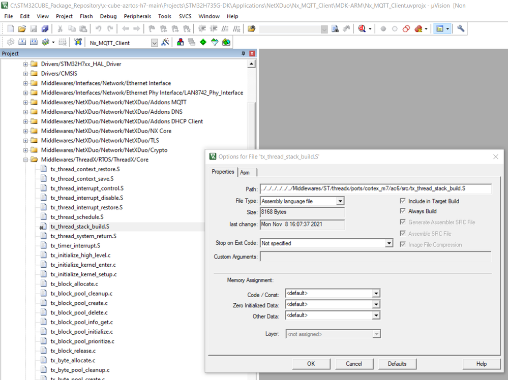

ok, I had to copy the /ac5/example_build folder over to ac6
so I could add the initialise_low file..
and like you said, the
... Repository\x-cube-azrtos-h7-main\Middlewares\ST\threadx\ports\cortex_m7\ac6\src\tx_thread_stack_build.s and tx_thread_schedule.s
I checked the ... Repository\x-cube-azrtos-h7-main\Middlewares\ST\threadx\ports\cortex_m7\ac6\inc file was already included in the linker folder list
but now there are huge numbers of errors...
nope wont compile...
build log attached
Can you check the MDK-ARM build ?
on a fresh Windows install ?

from the log pictures, I would say that you're trying to compile the wrong tx_initialize_low_level.s
Please use the one in the project folder:
x-cube-azrtos-h7-main\Projects\STM32H735G-DK\Applications\NetXDuo\Nx_MQTT_Client\Core

Yes, that low level init was ftom the AC6 folder I had to copy from the AC5 folder...
ok, switching to the new file ..
ok, thats much better , but still has a few issues,
now linking these 3 extra files to the cube project..
......Repository\x-cube-azrtos-h7-main\Projects\STM32H735G-DK\Applications\NetXDuo\Nx_MQTT_Client\Core\Src\tx_initialize_low_level.s
checking the other files: // please check these are correct...
......Repository\x-cube-azrtos-h7-main\Middlewares\ST\threadx\ports\cortex_m7\ac6\src\tx_thread_schedule.s
.....Repository\x-cube-azrtos-h7-main\Middlewares\ST\threadx\ports\cortex_m7\ac6\src\tx_thread_stack_build.s
ok, the new error list is tiny...
DTCRAM is overflowing ?
plus a couple extra issues, please revert back...
Thanks for the good work... almost there...
