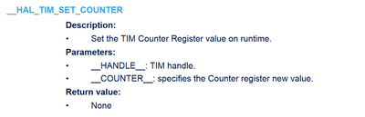

I am using a STM32L452RET6 and need to change the PWM frequency (and later the duty cycle) of Timer1 Channel 1 multiple times and on the fly. I tried using the following code but does not change the frequency:
htim1.Init.Period = 20000;
HAL_TIM_PWM_Start(&htim1, TIM_CHANNEL_1); //
Could someone please help with the following:
1) which registers do I need to change for frequency and which for duty cycle?
2) is that htim1.Init.Period = 20000; the correct way to change the frequency or do I need to call a dedicated function?
3) if that is the correct way, is there an additional HAL function I need to call to "load" that new value?
Thank you :)
TIM1->ARR
But I strongly recommend to have ARR preload on (TIM1->CR1.ARPE = 1).
TIM1->CCR1
I don't use Cube and can't help with that.

By re-initialization probably. HAL does not provide enough freedom to change TIMER settings. Even at some point, LL routines does not help.
Use LL whenever possible. More fun to play.
there are some API is of the type
you may refer to the HAL documentation for the specific Family you are using.
