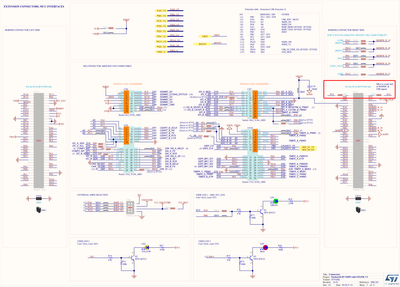

I’m trying to drive LEDs using all four PWM channels of TIM8 on a NUCLEO‑H755ZI, but I’m running into this issue:
CH1 (PC6) and CH2 (PC7): When I measure with a multimeter, I see the expected voltage fluctuations/average corresponding to the configured frequency and duty cycle.
CH3 (PC8) and CH4 (PC9): I’ve removed the LEDs and measure the pins directly with a multimeter; they always read 0 V.
I’m attaching the project archive, which includes the CubeMX .ioc file, tim.c , gpio.c , the driver layer, and all HAL settings. I’d appreciate any suggestions or insights you might have. Thanks in advance!

Did you connect the SB9 and SB20 solder bridges?

This change only affects the two relevant pins, right?
waclawek.jan
Yes; keeping in mind that those two pins are still connected to SDMMC socket, see schematics and the Nucleo board's manual.
