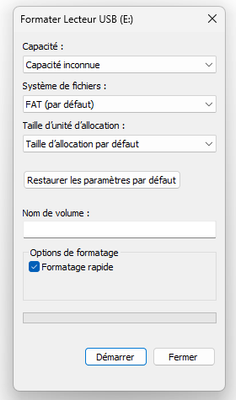

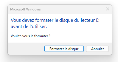

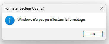

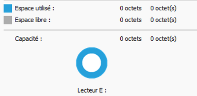

I am trying to set up an external flash memory (MX25V1635F) on a Nucleo-U575ZI-Q.
I have successfully used the low-level drivers (LLD) from the manufacturer Macronix and integrated them into the Levelx functions. (more info : https://community.st.com/t5/stm32-mcus-embedded-software/difficulties-using-fx-media-format/td-p/845435 )
Also, i use FileX to formand open my media, and it seems to work :

Windows see my disk but can't mount the volume :
When windows see my USB Device, it wants to format it (but i use FileX to format it in my code, so windows don't see it i think) :
And it says that windows cannot format the disk :
Do you have any suggestions ?

Windows only sees a USB drive and not a volume
