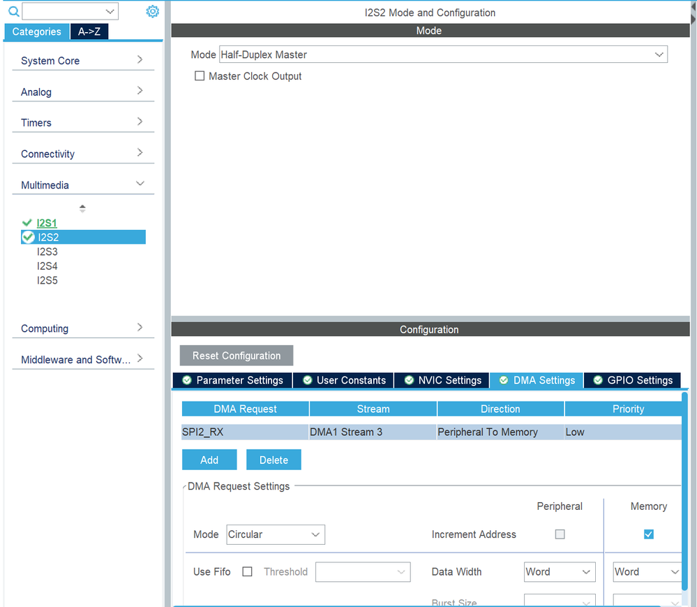

STM32F4: I2S1 DMA receives data from I2S2 when both interfaces run simultaneously
TheManOf
I'm working with an STM32F411 and trying to run two I2S master-receiver interfaces (I2S1 and I2S2) at the same time, each receiving data from a pair of PDM microphones using DMA circular transfers.
However, I found a very strange and extremely hard-to-debug issue:
Observed abnormal behavior
  1. When only one DMA is enabled, both I2S1 and I2S2 work correctly.
  2. When both I2S + DMA are enabled at the same time, the following happens:
    • If I2S1 has no microphone connected, it correctly receives all zeros.
    • If I2S2 does have a microphone connected, then I2S1 suddenly starts receiving non-zero data, even though no microphone is connected to I2S1.
    • It looks like I2S1 is receiving data that actually belongs to I2S2’s DMA buffer.
  3. Sometimes the behavior changes depending on the order of calling HAL_I2S_Receive_DMA().
  4. Both DMA buffers are allocated as global arrays (4 × 512-word buffers).
  5. I also tried disabling JTAG on PA15 (I2S1_WS), but the issue still exists.

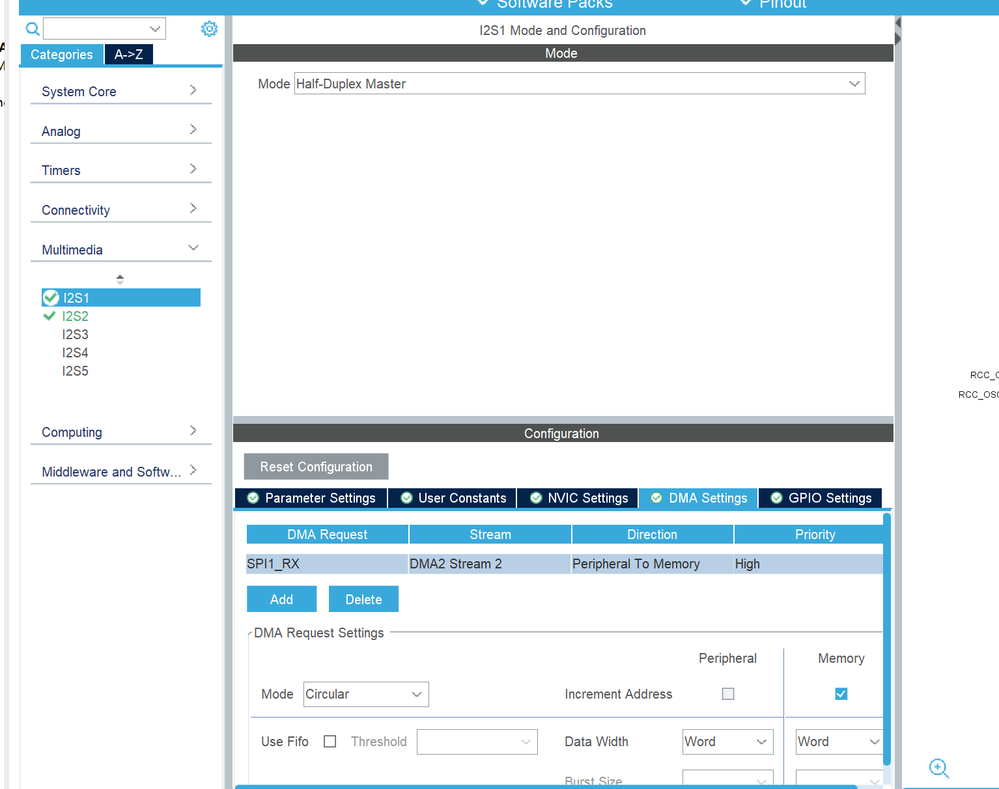

DMA config
  • I2S1 RX → DMA2 Stream2
  • I2S2 RX → DMA1 Stream3
  • Both in circular mode
  • FIFO disabled
  • 24-bit Philips I2S mode
The bug symptoms
  • I2S1’s DMA interrupt triggers normally
  • But the content of I2S1’s buffer seems partly “contaminated” by I2S2 data
  • Only the first element of each buffer is non-zero; the rest is zero
  • If I2S2 microphone is unplugged, I2S1 buffer becomes all zero again
This makes me suspect:
  • hidden DMA conflict?
  • wrong memory alignment?
  • a silicon errata related to STM32F4 DMA + I2S?
  • some CubeMX-generated initialization order bug?
I’ve been debugging this for a week and still cannot find the root cause.
Has anyone experienced cross-talk between two DMA streams on STM32F4 when using dual I2S master RX?
Any guidance or similar cases would be appreciated.

  /* USER CODE BEGIN 2 */
  HAL_I2S_Receive_DMA(&hi2s1,(uint16_t*)DMADMA,Number);
  HAL_I2S_Receive_DMA(&hi2s2,(uint16_t*)DMA,Number);

3 REPLIES 3
If an I2S input is not connected (i.e. floating), ascribe no significance you get to the numbers it returns. You should not expect to get all 0s, or all 1s, or any particular input whatsoever.

TheManOf
I have tested this many times. When the I2S input is floating, the values in micBuf are always zero — I have verified this repeatedly.
Additionally, even if I connect the microphones to I2S1, but leave I2S2 unconnected, the output of I2S1 is still all zeros, and **I2S2 is also all zeros.
Additionally, even if I connect the microphones to I2S1, but leave I2S2 unconnected, the output of I2S1 is still all zeros, and I2S2 is also all zeros.
