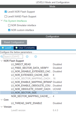

I am trying to set up an external flash memory (MX25V1635F) on a Nucleo-U575ZI-Q.
I have successfully used the low-level drivers (LLD) from the manufacturer Macronix and integrated them into the Levelx functions:

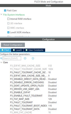

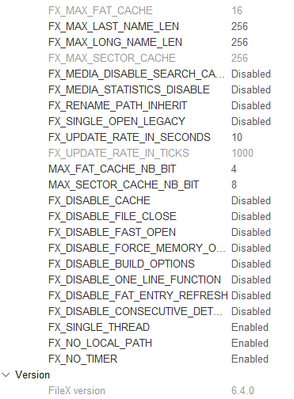

Here are my settings in the ioc :
