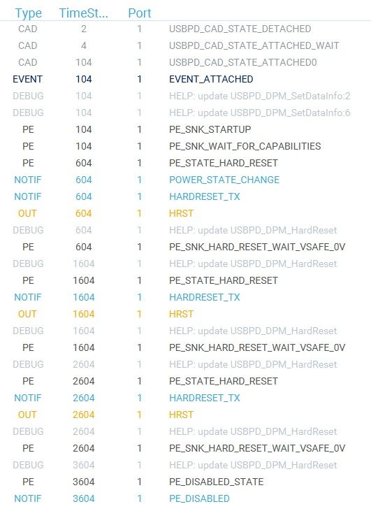

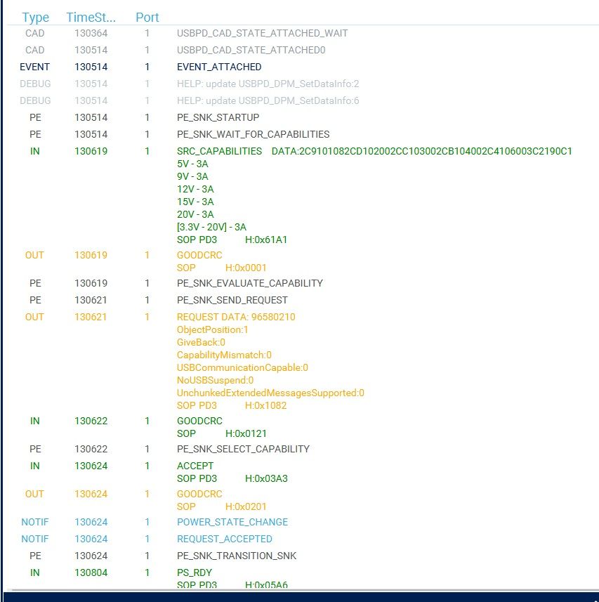

I am studying USB PD. I am using the demo board B-G474E-DPOW1 and the project from the STM32CubeG4 examples.
When I connect the USB-C cable to the charger, after the ATTACH event, I receive a list of possible profiles from Source.
0693W000007ESB3QAO.jpgBut when the cable is already connected to the charger and I reset the board, then after the ATTACH event, the list of profiles from Source does not come.
0693W000007ESBDQA4.jpgIs this normal behavior? Should source power profiles come only after cable connection?
How can I fix it so that after resetting the board, everything works same as on cable connection?

Dear @ADoro.2​
when cable is already connected, source port is not able to detect that CC connection has been lost.
Then sink should send a hard reset to reset VBUS on source side and wait for new source capabilities.
Unfortunately, in the code you are using, there are no code to check that VBUS goes lower than Vsafe0V (around 750mV)
Can you add the following user code in the function 'USBPD_PWR_IF_SupplyReady'?

In meanwhile, I detected with few chargers, that VBUS value by the disco board does not reach Vsafe0V. In my case lowest value was 1350mV.
Then, I needed to increase the threshold of 'USBPD_PWR_LOW_VBUS_THRESHOLD' to 1500mV.
#define USBPD_PWR_LOW_VBUS_THRESHOLD      (1500U)
In this case, I was able to receive correctly the new SRC capabilities after the hard reset:
