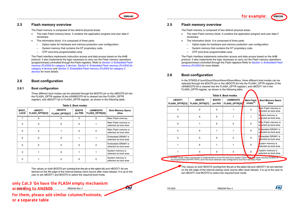

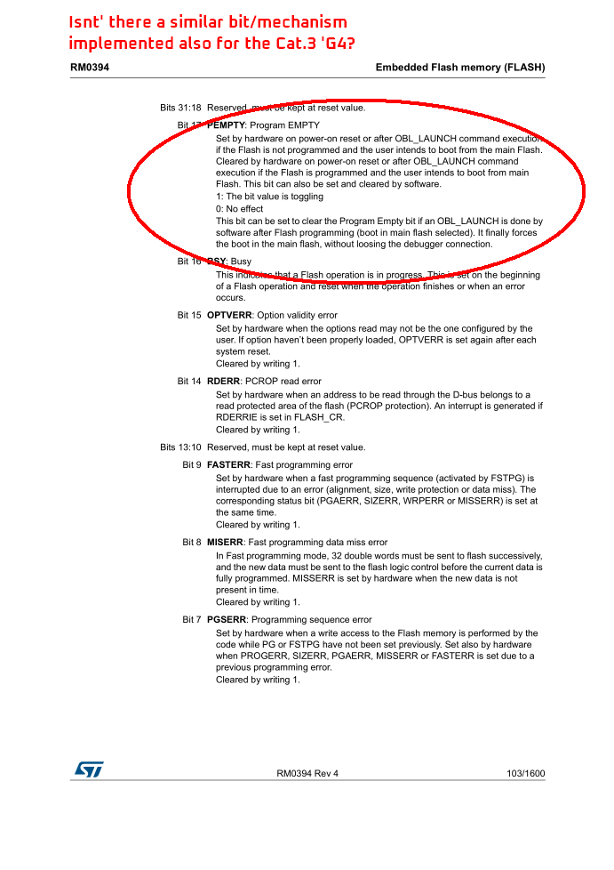

Also, please add the details of bootloader entry through empty FLASH for Cat3. into RM0440.

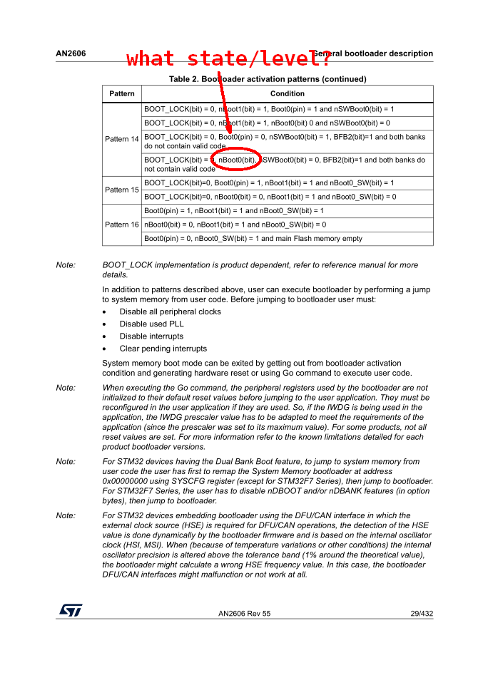

Hi @Community member ,
I confirm this issue in the Application note AN2606, table 2, pattern 14 the nBoot0(bit) should be 1.
Internal ticket number: 133433 (This is an internal tracking number and is not accessible or usable by customers).
Could you please tell us what you expect as "details of bootloader entry through empty FLASH for Cat3. into RM0440�?.
Thanks for your contribution.
Kaouthar
2022-08-22 7:23 AM
Hi Kaouthar,
@KDJEM.1
2022-08-23 2:22 AM
Hi @waclawek.jan (Community Member) ,
There is no empty check mechanism in STM32G4 devices.
But if option bit BFB2 = 1 (boot from Bank2 is requested) then embedded bootloader always started and before jumping to Bank 2 it checks if code in Bank2 is valid. If not then it check Bank 1 code - and if not valid then code stays in the bootloader. But this is valid only for BFB2 = 1 : the valid code in Banks is checked by bootloader code.
Regards
Igor
2022-08-23 7:26 AM
Ahoj Igor,
Thanks for the explanation.
Your description appears to imply, that if BLB2=1, hardware maps the System memory to address 0. The bootloader might've remapped it when it detects "valid code" in either bank, but it apparently does not do it, as witnessed by footnote to SYSCFG_MEMRMP.MEM_MODE description:
1.When BFB2 bit is set, the system memory remains aliased at @0x0000 0000
IMO, this should be added - maybe also as a footnote - to Table 5. Boot modes.
The reason is, that the combination of default VTOR=0 and System memory mapped at 0 causes the users to complain of "my code crashes at 0x1fffxxxx", which we see here quite often.
Also, RM0440 for the Cat.3 'G4 says:
Supports dual boot mode thanks to the BFB2 option bit (only in dual bank mode)
(emphasis mine). So, for the process you've described to work, is it necessary to program also to have DBANK=1, or will it work also when BFB=1 and DBANK=0?
It would be also nice, if AN2606 would be clear about what does "valid code" (and "Flash memory empty" in case of Patterns 6, 11, 13) exactly mean. I know the information is out there, if one searches well, but it would be nice to see it at the description of the Patterns, maybe as a footnote; or alternatively in the individual devices' chapters.
Thanks,
Jan
2022-12-22 12:37 AM
Hi @Community member,
This typo is fixed in AN2606 Rev 56.
Thank you.
Kaouthar
