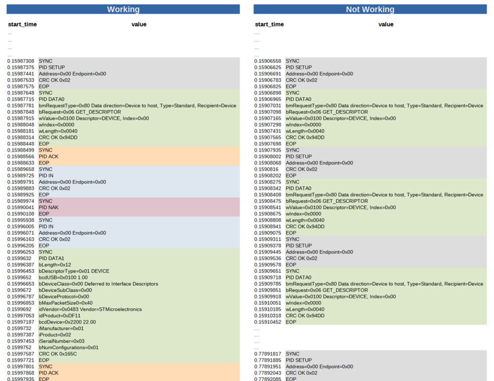

Follow up.
I've captured and decoded the USB communication using a logic analyzer. Here is a comparison between the STM32F070F6 (Working) and STM32F070C6 (Not working).
In the working MCU (STM32F070F6), after the first DATA0 there is an ACK, while in the other case (STM32F070C6) there is not. I think the MCU USB bootloader is not working and never replies to the PC.

Indeed, the sniffer log shows that the device never responds to the descriptor read request.
