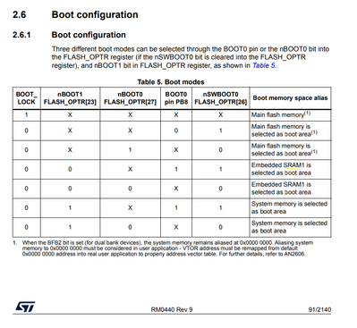

I am designing a card that will use an STM32G474QET6TR and I want to program it using USART.
The card will use a USB to USART converter (FTDI4232HL).
The Rx and Tx of the FTDI are connected to pin PA2 and PA3 respectively, as I found in AN2606.
My first question is how can I tell my MCU that it is supposed to use bootloader mode ? and Which pattern would be better to use ? Also, regarding the pattern, how do I tell the MCU that nBoot1(bit) is supposed to be a 1 or a 0 ?

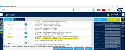

According t the BOOT_LOCK, nBOOT1, nBOOT0, BOOT0 nSWBOOT0 configurations, the MCU operates on the main Flash memory, boot from system memory...
For the STM32G474, the bootloader is activated by applying Pattern 14.
You can used the STM32CubeProgrammer to configure the option byte like as nBOOT0, nSWBOOT0 and nBOOT1.

Simply new MCU use automatic line 3 in pattern table. After first programm loaded (any way) only lines 1,2 work. Basic factory config is for line 1. Set boot pin high externaly and reset or power on. Open programmer select COM when USART is used and click connect.

To tell an MCU you have to start with the boot loader, this one must be configured as following AN2606 and pattern 14 in your case. From an hardware point of view the selection with pattern 14 allows 2 cases where Boot0 (pin) must be tied to 1 ( Vcc. 0 being ground).
Assuming this fact the MCU starts directly under bootloader mode (with two cases; one bank or double bank organisation).
