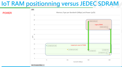

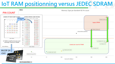

APMemory PN with "XX' (like APS512XXN-OBR or APS256XX-OBR) are supporting both OPI & HPI mode. The device is booting in x8 and can be swap to x16 by mode register. The command you mentioned are setting the configuration on the MCU side.
The benefit of using HPI x16 mode are following:
  1. Double the bandwidth versus OPI, up to 1Gbps and provide a pin count, power, and a very competitive advantage compared to SDRAMx32 (512Mb SDRAM x32 price example; 512Mb HPI price example)
  2. An other advantage of HPI versus OPI is active power, for the same amount of data tranfert, you can run HPI half of the time and consume much less power, spending more time in standby. https://www.st.com/en/partner-products-and-services/iot-ram-hpi-opi-psram.html
Below are illustrations of pin count & power benefit of OPI versus SDRAMx16 & HPI versus SDRAMx32
Hope this help
Alex
