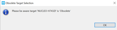

I have the new Nucleo-H743ZI2 board (note the "2" at the end of the board identifier).  I was trying to import some example project for the board using STM32CubeIDE example selector.  However I am stuck.  Completely.
  • The only examples available are for the earlier board edition (Nucleo-H743ZI). When I try to import such projects, the IDE refuses claiming that the board is obsolete.
  • When I specify the new Nucleo-H743ZI2 board in the examples Board Selector, there are literally *zero* examples for it.
  • No other option exist ...
You can import the examples of the Nucleo-H743ZI. This message
is just to inform you that the Nucleo-H743ZI is obsolete. You just have to click ok and keep going on generating your project.
Best Regards.
STTwo-32
Many thanks for all the answers.  I somehow got stuck in the IDE.  Even if I closed the message, I could not proceed with importing examples.  Still, the other approach I wrote about earlier worked.  I simply used File menu> Import...> General> Existing Projects into Workspace, and pointed to example project of interest located under:
C:\Users\USERNAME\STM32Cube\Repository\STM32Cube_FW_H7_V1.11.1\Projects\NUCLEO-H743ZI\Examples\
That did the trick.  I should have thought about this solution earlier :smiling_face_with_smiling_eyes:
