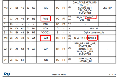

Does your application put the CPU to sleep, and/or disable or reconfigure the SWD pins?
The application/code doesn't put the CPU to sleep .  The flashing or debugging is using a ST-Link (a USB wire). In STM32CubeIDE , during debug mode , i am facing this issue . Could you explain the disable  or reconfigure the SWD pins mean here ?
Thanks
Sudarshan
The SWD lines (SWDIO and SWCLK) are on PA13 and PA14:
So, if your code does anything to PA13 and/or PA14, it will break the debug connection.
