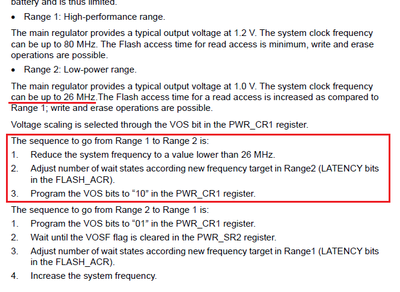

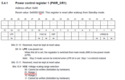

mƎALLEm
According to the RM, the dafault PWR config after reset is VOS1:
And there is a sequence to switch from VOS1 to VOS2:
Also what is your system frequency? You can't exceed 26MHz at VOS2!

mƎALLEm

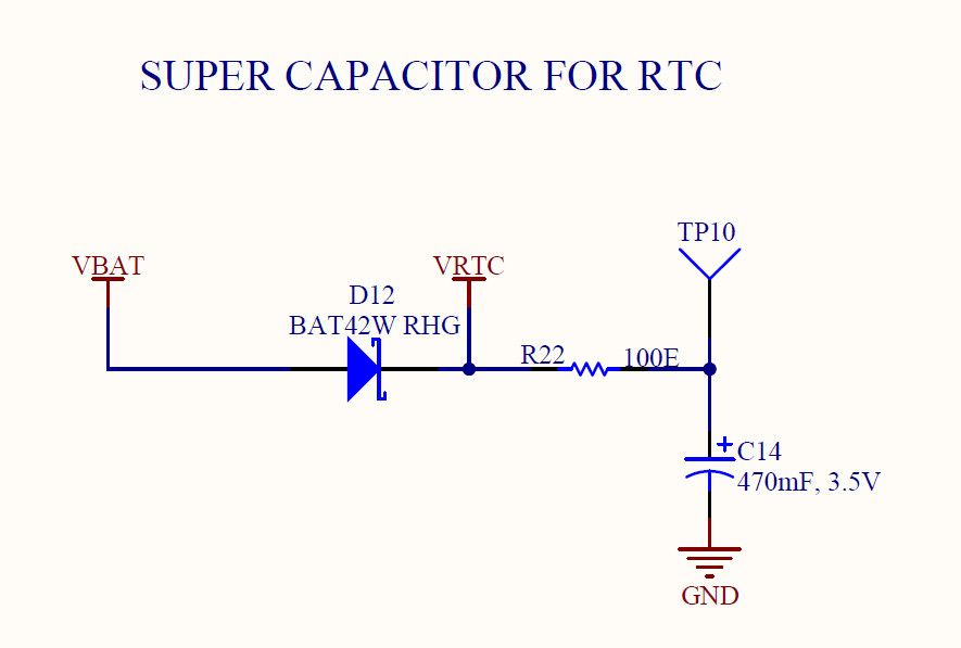

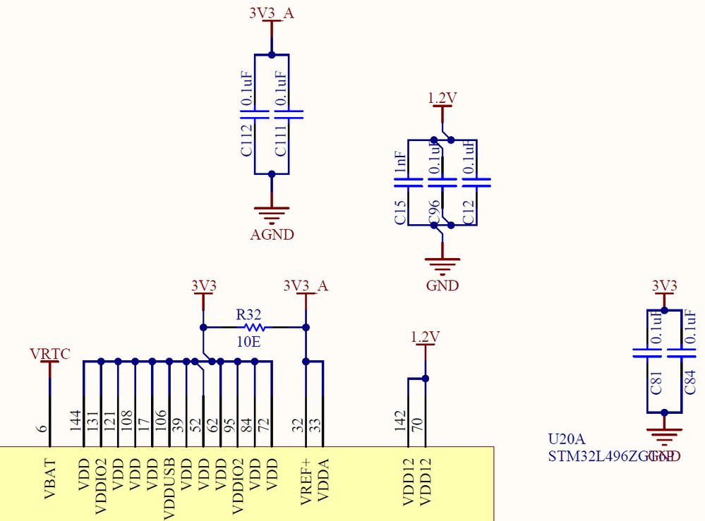

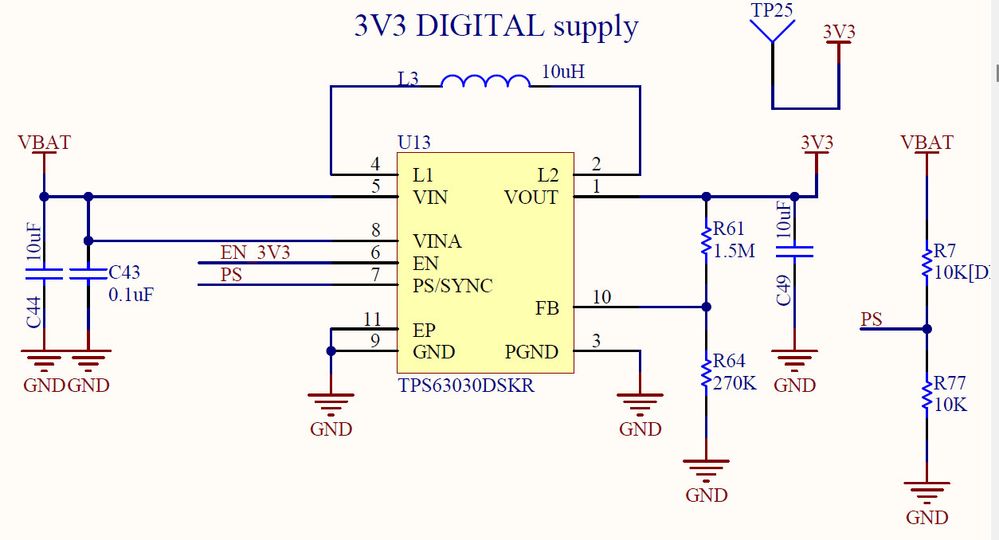

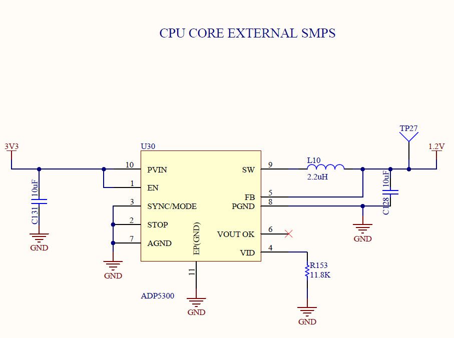

About the hardware i share some photo about the power supply:
I've already said: you need to implement the sequence to switch from VOS1 to VOS2.
To me it's not a HW issue for the moment. You need to implement the sequence as described in the RM.

As already noted, you can't run at 40MHz with VOS2 - Therefore this code
	/*Configure the main internal regulator output voltage*/
	if (HAL_PWREx_ControlVoltageScaling(PWR_REGULATOR_VOLTAGE_SCALE2) != HAL_OK)
needs to check that you are in the USE_20MHZ_CLOCK mode ...
