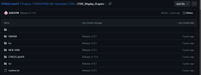

You need to download the all package from this link
Then go to this path: \Projects\STM32H7B3I-DK\Examples\LTDC

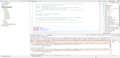

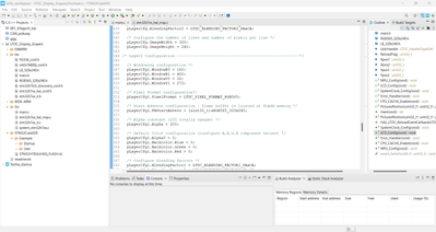

Maybe a *** question but repo does not have the classic "Code<>" button where I can just copy the URL. Is there any other way to download the code?
I downloaded code but I dont know how to flash it to board. I opened the project in STM cube IDE but it does not allow me to build it. I went to File > Open Projects from File System and chose the LTDC_Display_2_Layers folder. Is there any other correct way?

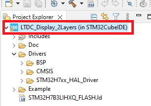

SofLit
How you did open the project?
This is what you have to get as view:
You need to have "IDE" label in blue square on the project view.
I did manage to load it into workspace, but when I tried to build I get this error , in which folder should I paste that header file?
