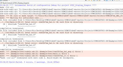

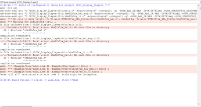

2024-03-01 2:48 AM
I have tried to build a lot of examples , and every one of them has errors.
2024-03-01 5:08 AM - edited 2024-03-01 5:17 AM
Please re-download the package from here and build the project as it is .. There is no problems with the projects.
Also try to shorten the path to the projects from your drive root for example copy your STM32CubeH7 package directly under C: as Windows uses a path length limitation.
2024-03-01 5:15 AM
@richi The firmware library uses relative paths and expects .c/.h files to be located at a specific relative position. So you cannot simply copy an example from the firmware structure and expect everything to be compilable.
Have you tested the examples directly from the directory structure recommended by @mƎALLEm , i.e. without copying them anywhere?
2024-03-01 2:08 PM
I did , they out of the box cannot be built because they throw errors that stm32h7xx.h is missing
2024-03-01 11:11 PM
I can see from your screenshot that you are neither working in the unchanged directory structure nor using a short path as suggested by @mƎALLEm. As long as you do not implement this, you will always have problems.
2024-03-03 2:05 AM
I must say that I dont understand what does it mean to "test the examples directly from the directory structure". I tried to go File >> Open Projects from File System choose the LTDC_2Layers directory , but then I am unable to build the project. If I go to LTDC_2Layers and click on the .project file it imports my project in Cube , I build it and the above picture is the result. I changed relative path in C: but error persists.
2024-03-04 12:22 AM
When CubeMx suggested you to download the H7 library did you do it?
You need to have the H7 cube package on this path <user>\STM32Cube\Repository\STM32Cube_FW_H7_VX.YY.ZZ
No need to import the project from File >> Open Projects . Simply open the project by clicking .project file.
