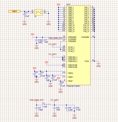

I am designing a board based on STM32h755zit6 MCU and it's the first time for me working on this MCU, I am trying to simplify the design as possible to avoid any problem in the development, since we are short in time.
I found out that there is a firmware configuration for the power, is there a default configuration so I can make the hardware based on it? right now I made this schematic based on the Nucleo board, but I want to make sure that it's right configuration, Also I have the ST-link 2 is it possible to use it for programming?
thanks

Again please review the AN4938 "Getting started with STM32H74xI/G and STM32H75xI/G MCU hardware" development:
And reference design schematics:

Better to remove the grid from the background in your schematics for more visibility.
Thanks.

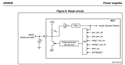

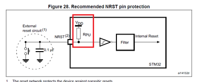

Shouldn't there be a pull-up resistor (typically 10 kΩ)  connected to the NRST pin?
No need for external pull-up resistor on NRST pin. There is one internal:
No - As @mƎALLEm said, there's one internally.
See Application note AN4938Getting started with STM32H74xI/G and STM32H75xI/G MCU hardware development:
https://www.st.com/resource/en/application_note/an4938-getting-started-with-stm32h74xig-and-stm32h75xig-mcu-hardware-development-stmicroelectronics.pdf#page=17
@baselimadt - study that app note.

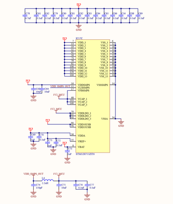

here is a picture without it

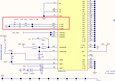

Did you check against Chapter 2 of AN4938?
It's all about power supplies:
https://www.st.com/resource/en/application_note/an4938-getting-started-with-stm32h74xig-and-stm32h75xig-mcu-hardware-development-stmicroelectronics.pdf#page=7
I did read it in a hurry, but I found that people still facing problem with it here in the community, so I decided to make a quick review with you, to make everything is good.
since we don't have time for redesign if there were a problem
To me, C74: you have 150pF but in the Nucleo-H755 is 220pF so I suggest to use that value.

2. I reminder you that pin17(VFBSMPS) is an input pin, not a power pin.
3. Normally, if it's a first design your side, to reserve some 0R would be better, easier to debug.
