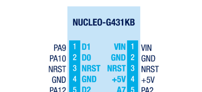

I would like to know if I could power up my 10 5V sensors. so i would like to know if I can use the +5V of my board and the current capacity of it to power up my sensors.

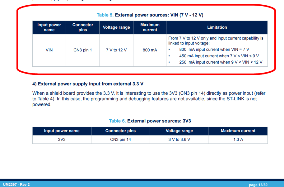

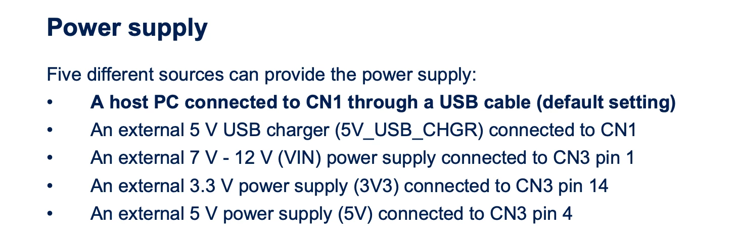

My other question would be around the power supply of the board, It seems logical to use 7V and 800 mA to power it up so I will have as much power possible to use my 5V for my sensors. Is it the correct way to think?

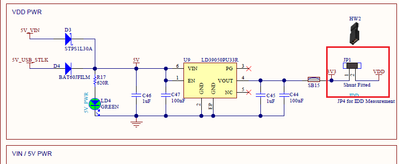

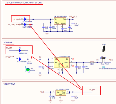

Measure the consumption on JP1 while running the application:
But seems not only the target MCU that pulls the current from LD1117 but also the STLINK block: MCU+LDO+ LEDs:

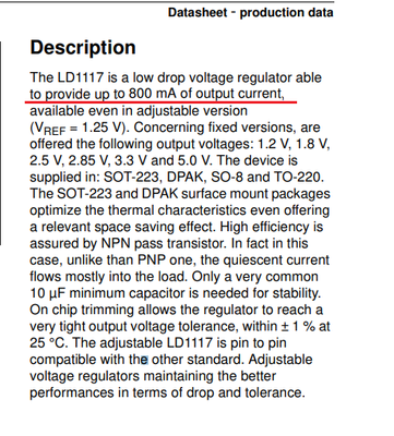

@Jad wrote:
Good morning.
I am wiling to use the STM32G4 Nucleo-32 board (MB1430) board for an analog to CAN use.
That depends on the load that LD1117 (the 5V regulator) will reach with your sensors. According to its datasheet the current should not exceed 800 mA of output current:
Yes - so long as the total of the Nucleo board and all your sensors doesn't exceed the power supply capacity.
The limiting factor here is going to be the power dissipation in the regulator - see Table 5 in the User Manual:
https://www.st.com/resource/en/user_manual/um2397-stm32g4-nucleo32-board-mb1430-stmicroelectronics.pdf#page=13
So, from a 7V input, it should be able to give 800mA total for both the Nucleo itself and any added loads.

Figure 8 in the UM shows you how all the various supplies & regulators relate
