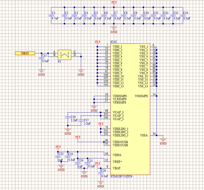

I am designing a board based on STM32h755zit6 MCU and it's the first time for me working on this MCU, I am trying to simplify the design as possible to avoid any problem in the development, since we are short in time.

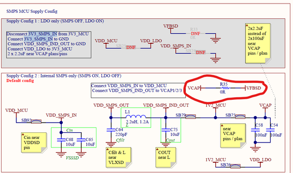

I found out that there is a firmware configuration for the power, is there a default configuration so I can make the hardware based on it? right now I made this schematic based on the Nucleo board, but I want to make sure that it's right configuration, Also I have the ST-link 2 is it possible to use it for programming?

After reading the chapter, I have decided there is no need for the SMPS, so here is the updated design, can you please check it? do I need to connect VCAP to GND, since in the Nucleo board it is connected to the VFBSMPS which is connected to GND, or the highlighted resistor will be removed?
thanks

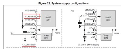

-> So as I understood you switched to the LDO config.
Reviewed but not in deep..

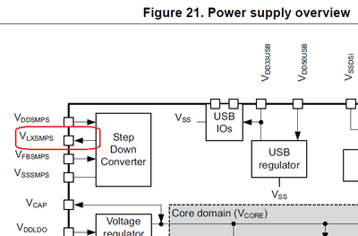

-> VLXSMPS needs to be kept floating according to the RM0399 figure 22:
It's an output from the SMPS:
ok Done,
What about Vcap DO I need to connect the pins together? I remember working on the STM32f4 there was no need to connect these pins together, only with CAP 2.2uF
