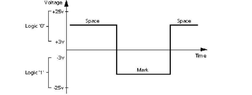

Can I use a voltage level shifter and then connect to UART pins of micro?
If you mean by "a voltage level shifter" to replace the transceiver, the answer is no.
This is the ranges for RS232 with negative voltage:
So please use a suitable transceiver.
