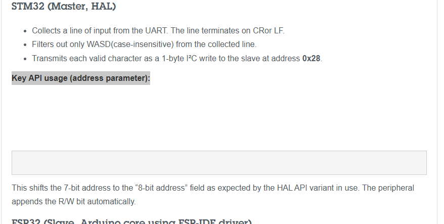

Key API usage (address parameter):
This shifts the 7-bit address to the “8-bit address” field as expected by the HAL API variant in use. The peripheral appends the R/W bit automatically.

Something seems to have gone wrong with your "Key API usage (address parameter)":
@tantheman wrote:
6 REPLIES 6
Andrew Neil
Is there a question, or are you just presenting this as something others might find useful?
@tantheman wrote:

yes the key api usage was showing highlighted errors while posting ... so just put the code instead ......

HAL_I2C_Master_Transmit(&hi2c1, (0x28 << 1), &c, 1, 10); key API usage
