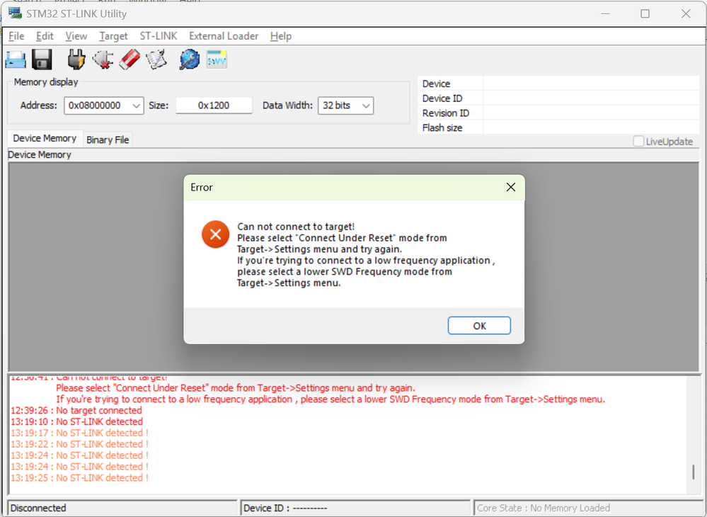

We are using STM32CubeIDE to configure the STM32 controller. Previously, flashing the code to the board was working fine. Recently, while trying to debug, the IDE started showing this error: "Failed to execute MI command""Error in initializing ST-LINK device" We tried upgrading the ST-LINK driver, and the controller responded to the host. In STM32 ST-LINK Utility, we could select the External Loader, which means the connection seemed okay.However, when we tried to erase the flash using ST-LINK Utility, we got:
"Target not connected" We tried many solutions in STM32CubeIDE, but we could not identify the root cause. Could anyone please help us understand what might be going wrong?

‎2025-04-16 5:51 AM
‎2025-04-16 6:43 AM

Please use STM32Cubeprogrammer, ST-Link utility is deprecated:
The error message "No device found on target" indicates that the STM32H7 is probably not powered, or is in a state where it can't be accessed.
Please download the User Manual , and check the jumpers and solder bridges configuration.
