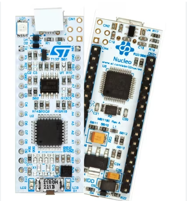

Nucleo-32 format?

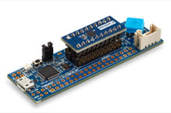

Or STM32C0116-DK:

Nucleo-32 format?
Or STM32C0116-DK:
Thanks, I didn't notice that the Nucleo-32 format is that small !
I have a few discovery Nucleo-64 and Nucleo-144 boards, which are huge in comparison.
If I am not mistaken, this is the form factor of a DIL-40 package (like e.g. the Z80).
As an additional bonus, the Nucleo's have debug access and an onboard debugger, which many "Arduino" boards lack.

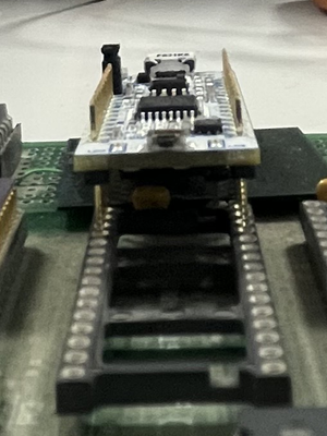

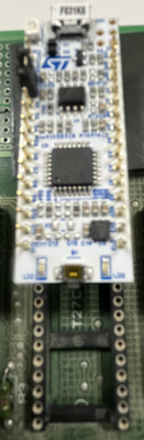

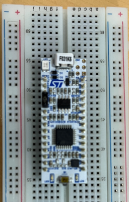

This is the real size on a bread board:
I have a few breadboards of different sizes, so it's still difficult to assess the actual size.
But I checked both the Nucleo-32 reference manual and the (original) Z80 datasheet for measurements, and they are identical within a few millimeters.
As you can see it fits the DIP-40 socket in width:

STM32C0116-DK has a daughter board that contains the target C0 MCU that fits DIP-20 socket having 16 IOs available excluding debug pins.

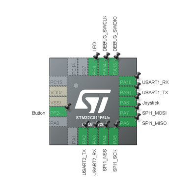

From CubeMx based that board selection:
But still you need to plug this daughter board on the mother board for debug, contrarily to the Nucleo-32 board having the onboard ST-LINK. But you still have the access to the bootloader using USART1 over PA9/PA10.
Thanks, I think I consider this as well.
I am fine with that, connecting a debug pod to broken out pads or pins is relatively easy.
