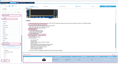

thanks for the response @Andrew Neil
If i'm not overstepping my bounds, given the requirements of an audio classifier (also need wifi support and display support), which ST board would you suggest.  This is simply for prototyping purposes.
Thank you in advance.
Danny
KDJEM.1
Hello @edwards09 ;
First of all I apologize for my late reply.
I recommend you to use STM32CubeMX to find the board with different requirement.
I think STM32H7S78-DK achieve your requirement.
Thank you.
Kaouthar
