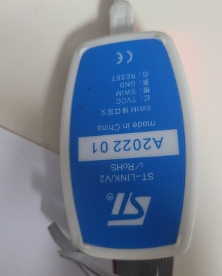

您好,请教一下,st-link v2连接电脑USB线束接错会不会损毁st-link?

If you have this programmer, it was not made by ST and is not guaranteed to work with ST tools, either with or without a USB extension cable.

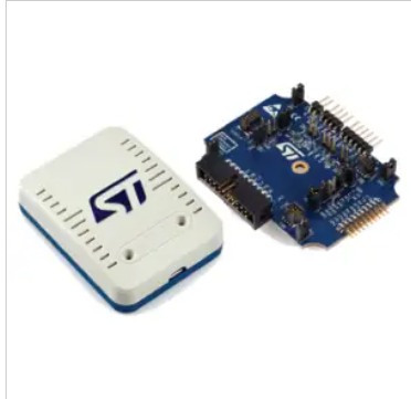

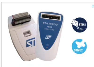

There are different STLINK versions available on the market, two of them are:
ST-LINK-V2:  https://www.st.com/en/development-tools/st-link-v2.html
and ST-LINK-V3: https://www.st.com/en/development-tools/stlink-v3set.html
So could you confirm which one you have? or at least post a photo for it top and bottom of it?

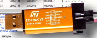

@abczhang wrote:
 The one I'm using has a different shape; it has two interfaces, one STM32 and one STM8.!
So one like this:
Yes?
You still need to check that it is a genuine ST one.

+ If you have this one as bottom image with Chinese text, it's a ST-LINK clone:
Please read this thread: ST-link V2 Connection error
Bad USB cables are out there, often charging cables, lacking data wires or improperly twisted/shielded. This is a bigger problem for USB 2.0 High Speed (480 mbps).
Hubs and Docking Stations can give issues with ST-LINK, I've seen issues with data integrity and failure, as the protocol isn't robust. Perhaps sequencing or retry issues.
I suspect non legitimate ST-LINK can be ignored or bricked.
