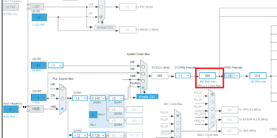

@JLope.11 wrote:
The controller was hot, perhaps PLL was run at much more than 480Mhz and burned
I did the exercise with CubeMx based on the source code you shared and don't see any issue with these parameters you are in the specifications:
So I don't see how the chip was burned! I suspect the issue is coming from something else..
