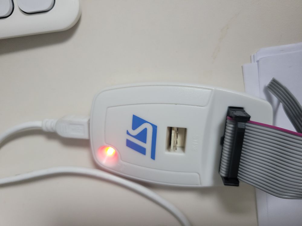

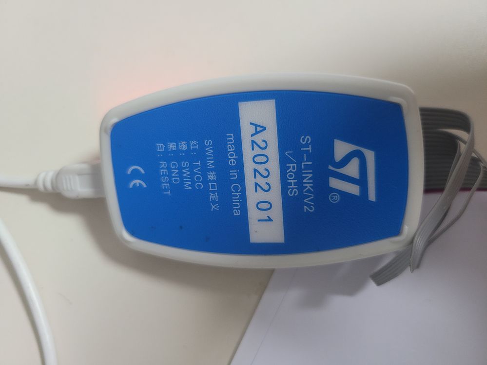

How do I solve this error? "Error: No STM32 target found! If your product embeds Debug Authentication, please perform a discovery using Debug Authentication"
I use SWD. I made the cable for SWD communication. The cable is connecting ST-LINK V2 between board.
Yesterday, well, was connected to STM32CubeProgrammer.
But today it wasn't connected suddenly.....
I did everything I could by exploring the STM32 community.
Changed ST-LINK V2, the cable, reset mode, etc......
I saw massage what "ST-LINK error (DEV_TARGET_CMD_ERR)" in hardware rest mode.
But I don't solve this error.
Please help me....

Welcome @KimJeBu, to the community!
Can you please post a photo of the ST-LINK/V2 you are using?
Regards
/Peter
KimJeBuAuthor
September 17, 2023
Of course. Thank you for your kindly.KakaoTalk_20230917_231024451.jpgKakaoTalk_20230917_231024451_01.jpg
Peter BENSCH
Peter BENSCHBest answer
September 18, 2023
ST-LINK/V2 are very often illegally cloned, even the labelling of the packaging card and the housing are copied elaborately.
There are several ways to recognise a clone: you could, for example, open your ST-LINK/V2 (one screw is under the sticker on the back between the logo and the edge, another one is roughly where you have the word "SWIM") and you would then find a fake STM32F103. If you don't want to damage the sticker, you can also try to upgrade the ST-LINK/V2 with the STM32CubeProg (disconnected and right in the middle "Firmware Upgrade"). If this upgrade fails, which you can already tell from the missing or implausible serial number, you have an illegal clone and should contact the manufacturer of this clone - or buy an original ST-LINK/V2.

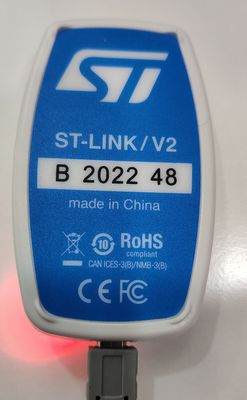

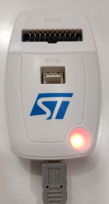

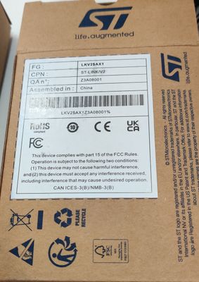

It seems I have the same problem
Although I agree ST should protect their product I would expect it would prepare the customers for this decission. I used to buy STF103 MCU and ST Link V2 ( "fakes" ?? ) from fastest supplier not really looking if original or not...
I have an original ST Link V2 from ST on the back is [B 2022 48 ] just purchased 2 days ago from Digi Key ( your trusted supplier/distributor ).
I have several bluepills STM32F103C8T6 that in the STM32Programmer are visible, can connect and read memory. Amyway, when I connect to STM32CubeIDE I get the error "Cound not verify ST device !" or "No STM32 target found!".
Can anyone suggest an issue??
The ST Link V2 FW after update is ... V2J43S7
It can read memory in STM32Programmer
In STM32CubeIDE it does not connects ...
A photo with hardware - all seem original.
Peter BENSCH
January 11, 2024
@CSand You are trying to access a Blue Pill with STM32CubeIDE via what appears to be a genuine ST-LINK/V2. Why would STM32CubeIDE program a fake MCU that it doesn't know?
