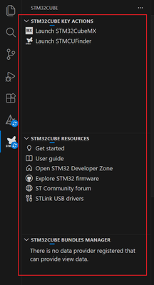

When opening a project directory in VS Code, the STM32CubeIDE for Visual Studio Code extension gets stuck in an infinite loading state (as shown in the screenshot below).
Symptoms:
  • "Go to Definition" does not work.
  • The Build Analyzer view does not appear.
  •  clicking the "Build" button still triggers a successful compilation.
  • Most dependent extensions, such as STM32Cube CMake Support, remain inactive

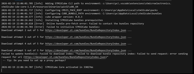

Here is the log output from STM32Cube Core during the failed loading:
I discovered that if I completely disconnect my PC from the internet before launching VS Code, the extension reports a network error but then successfully initializes after a short period. Once initialized offline, all features (including Go to Definition) work perfectly.
Here are the logs from a successful (offline) launch:
My computer’s network connection is working fine. I tested this URL in the VS Code command line —developer.st.com/bundles/BundleRepositoryIndex.json — and it downloads normally. I’ve tried both the latest version (3.7.0) and the older version (3.6.4), but neither fixed the issue. Right now, the only way I can open it is by disconnecting my computer from the network. Is there any way to solve this problem?

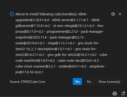

If first time install have you seen bottom right notification asking you to accept STM32Cube bundles install as extra of extensions ?

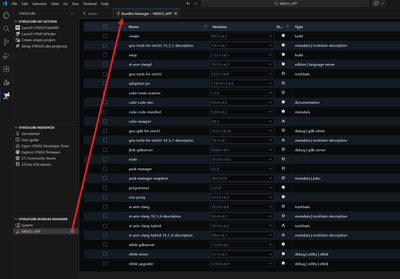

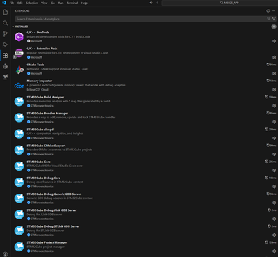

Here is a screenshot of all the extensions currently installed in my VSCode:

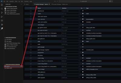

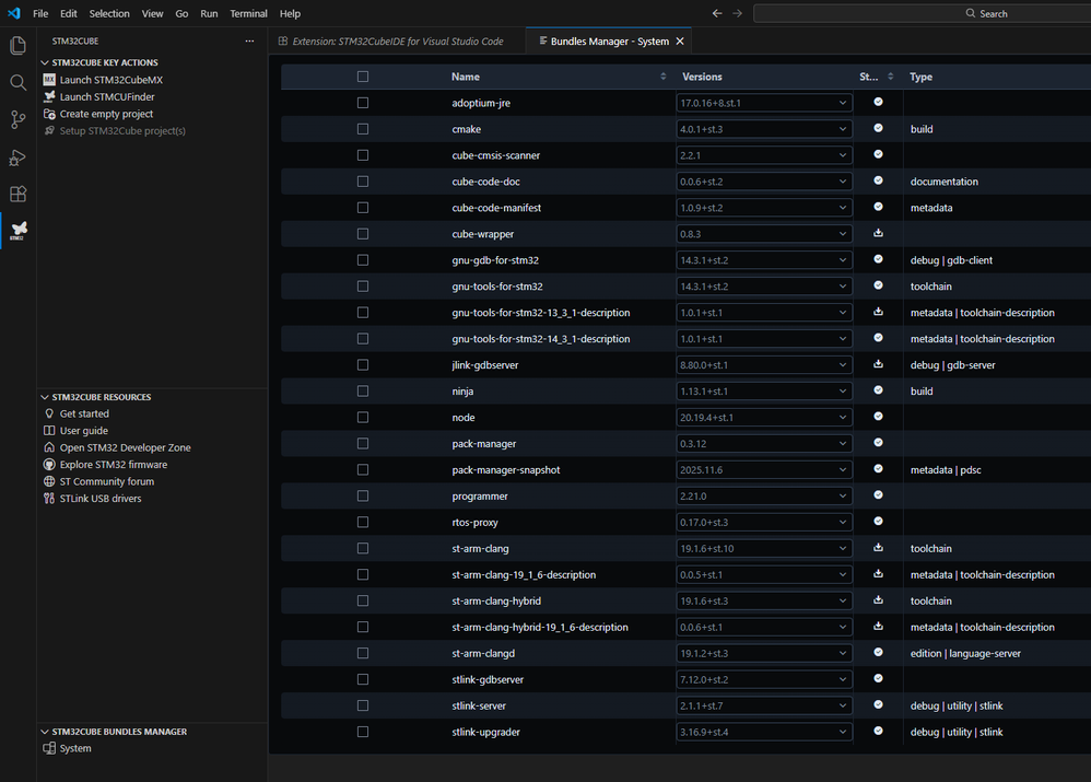

I also found a panel called "STM32CUBE BUNDLES MANAGER", and I’ve attached a screenshot of it.
For reference, my system information is:
- Windows 11 version 24H2
- VSCode version 1.109.4

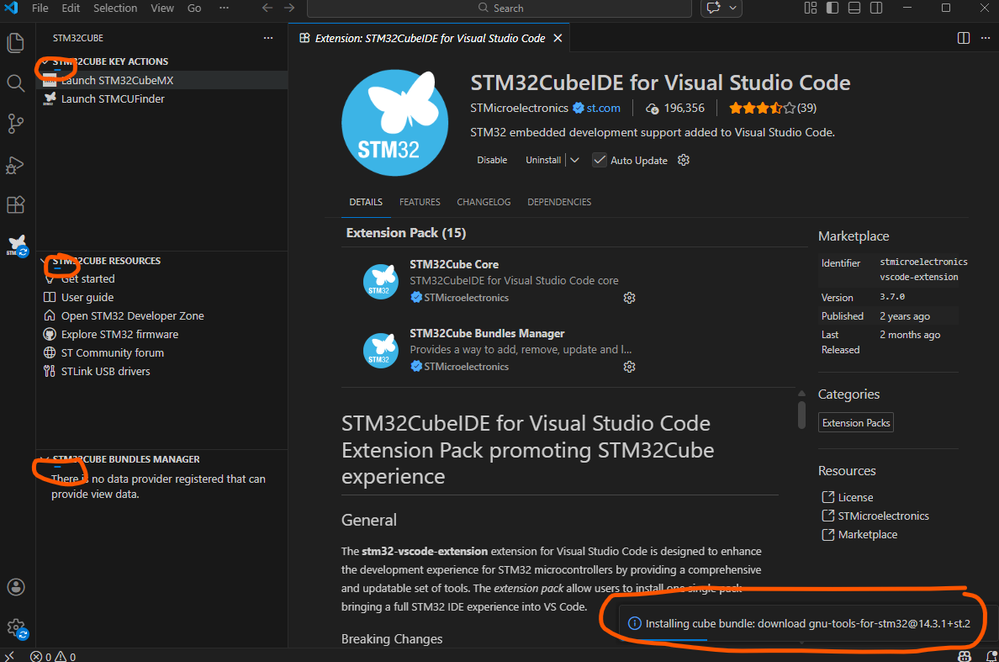

@LiHua
I've got a try just now
My system information is:
- VSCode version 1.109.5
From scratch setup: is ok on my side
1)  Bundles install notification I've accepted
2) Extensions are pending bundles install completion
3) Finally I'm getting hand back and bundle are set ok

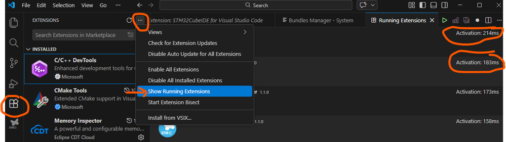

Maybe have a try about an incremental setup to identify what is blocking on your side.
+ As first step, from clean env., have just a try to install not the extension pack but the very first extension of which is https://marketplace.visualstudio.com/items?itemName=stmicroelectronics.stm32cube-ide-core.
It should manage bundles install too.
+ Once ok have a try about https://marketplace.visualstudio.com/items?itemName=ms-vscode.cmake-tools
+ Once ok have a try about https://marketplace.visualstudio.com/items?itemName=stmicroelectronics.stm32cube-ide-build-cmake
+ Once ok have a try about https://marketplace.visualstudio.com/items?itemName=stmicroelectronics.stm32cube-ide-bundles-manager. Are you able to get bundle manager GUI up & running ?
"Once ok" means extension activated

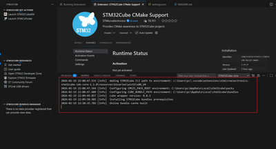

Thank you very much for your suggestion.I also updated my VSCode version to 1.109.5, but the issue still remains.

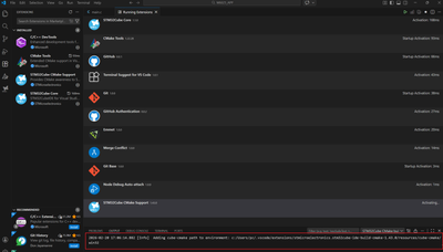

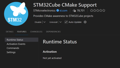

After cleaning my environment, I followed your steps and installed the extensions one by one. However, at step 3, STM32Cube CMake Support got stuck while activating.
I tried restarting VSCode, but STM32Cube CMake Support always stays in the “Activating” state and never finishes.
Below are its logs. 
Could this be caused by a network issue on my side?
Hi @LiHua,
Does "STM32Cube CMake Support" never activate even if you don't have any folder/workspace opened in VSCode ?
