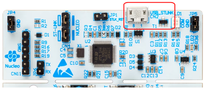

I need some solution. Issue is stm32G0b1re nucleo board is detecting as Jlink device in device manager. But I want this to detect as STM stlink device.
I have uninstall driver then it is decting as USB port. Even I have tried to install stsw-link009 driver. But somehow it is not installing driver. As I can't that in control manager.
let me know what to be done to update driver so that I could see it as STM stlink device.
And you are using the built-in debugger on the Nucleo board itself - via CN2 - yes?
In that case, you (or somebody before you) must have converted that ST-Link to a J-Link using Segger's converter:
https://www.segger.com/products/debug-probes/j-link/models/other-j-links/st-link-on-board/
You can use that same converter to reverse the process: Restore ST-Link Firmware.
