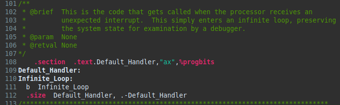

the hole batch of F030C6T6 has same behavior :
can access with ST-Link , program, verify - all ok. read core registers, option bytes...ok.
but then no program start ! chip stays in startup here:
0693W00000Uo3uMQAR.png10 tested boards ihave identical behavior. chips coming from PCB assembler , as usual.

@Community member​  , there is no "normal" debug possible, first and only thing is start und stuck at : b Infinite_Loop . restart, reset always comes to this line in startup.s no stepping or anything else than leaving debug session is possible. ok, reading registers, flash etc is ok, but no step in program execution.

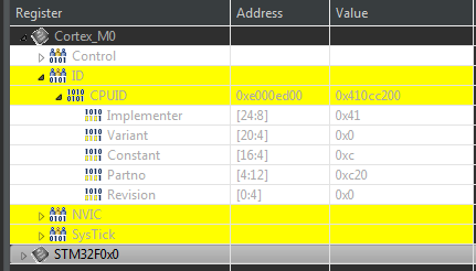

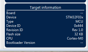

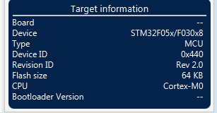

so - here we are:
old (1..2 years) board: C8T6 variant
with new chip: C6T6 (because C8 not available)
and ID : (in cubeIde )

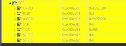

and SCB_ICSR :
VECTACTIVE:

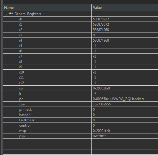

and registers at infinite loop:
so seems WWDG is doing this - but is off.
i had this idea, because WWDG_IRQ shown, but setting option bytes to Hardware and back changes nothing.
any idea ... or kick them to trash ?
