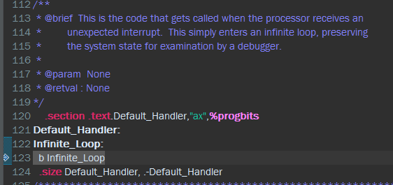

(programmed) STM32F030 stucks in the startup (xx.s ) forever. defective batch ??
AScha.3
the hole batch of F030C6T6 has same behavior :
can access with ST-Link , program, verify - all ok. read core registers, option bytes...ok.
but then no program start ! chip stays in startup here:
0693W00000Uo3uMQAR.png10 tested boards ihave identical behavior. chips coming from PCB assembler , as usual.
I replaced one with a (suspect source , from aliexpress dealer) F030 , then board running as it should.
  • can i do anything, to get these boards running?
  • if chips have all same defect, how is it possible to passing the wafer test ??

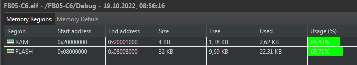

new project with C6 version (is really small program):
0693W00000UoKLJQA3.png--- but still same effect: stalled in startup...
0693W00000UoKMvQAN.pnghere pic - looks original - right ?

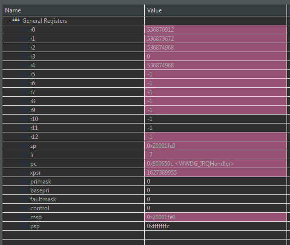

Could you send registers values table in infinite loop?
AScha.3
see in my post from yesterday, registers at loop. (in black area)
ONadr.1
Senior III
But they are from another bin file. We need from new bin file (for C6 MCU).
AScha.3
aaa. ok. BUT : now cpu is running !!
debug waits at program start in "main" , as usual.
just i dont know why...i set optimizer on -O2 (was -O0 );
i tried some times...now again stall in startup.
registers :
confusing...
ONadr.1
Senior III
It si weird. Stack pointer (sp) has value 8160byte. Like there is 8kb memory set.
Check linker script (.LD)
Top-of-Stack needs to be 0x20001000 (4KB) or below. Check first vector.
Right now you're faulting directly out of reset, and perhaps into a catch-all handler everything points too.

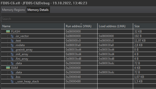

from .LD :
/* Entry Point */
ENTRY(Reset_Handler)
/* Highest address of the user mode stack */
_estack = ORIGIN(RAM) + LENGTH(RAM); /* end of "RAM" Ram type memory */
_Min_Heap_Size = 0x200 ; /* required amount of heap */
_Min_Stack_Size = 0x400 ; /* required amount of stack */
/* Memories definition */
MEMORY
 RAM   (xrw)   : ORIGIN = 0x20000000,  LENGTH = 4K
 FLASH   (rx)   : ORIGIN = 0x8000000,  LENGTH = 32K
/* Sections */
SECTIONS
 /* The startup code into "FLASH" Rom type memory */
 .isr_vector :
   . = ALIGN(4);
   KEEP(*(.isr_vector)) /* Startup code */
   . = ALIGN(4);
 } >FLASH
and in IDE shows:
looking ok for me.... or not ?
