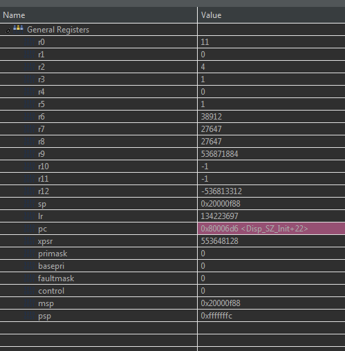

funny: now (still same program, changed nothing intentional ) starting normal, cpu registers now:
0693W00000UoMF8QAN.png but...i run compiler again , just to see: 0 warnings , 0 errors .

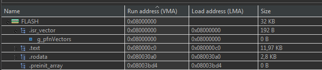

Expand the isr_vector so we can SEE the content, ie what the processor is actually loading into it's registers at startup, and what over handlers are pointing too.
Check the _estack symbol
That is typically loaded by the processor, and often loaded a second time into SP in ST's startup.s code.
Processor will fault the first time anything pushes onto the stack, ie PUSH LR and then the processor's going to have all kinds of issues because it will try an push context onto the stack, basically double faulting.
AScha.3
isr_vector ...in IDE ?
0693W00000UoMMYQA3.pngor where to look ?
_estack symbol -- is where ?
