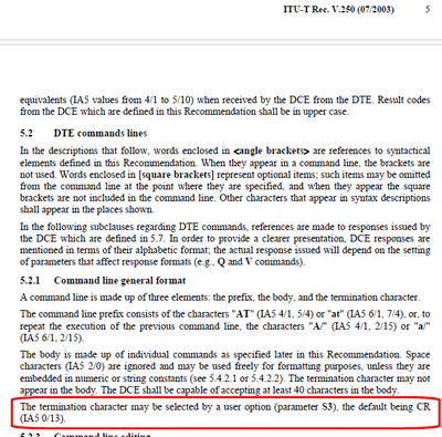

The AT command terminator should be just CR.

Some GSM modules can echo back sent characters. Try sending simple AT commands like AT\r\n and see if you get an OK response.
@liaifat85 wrote:
 Try sending simple AT commands like AT\r\n .

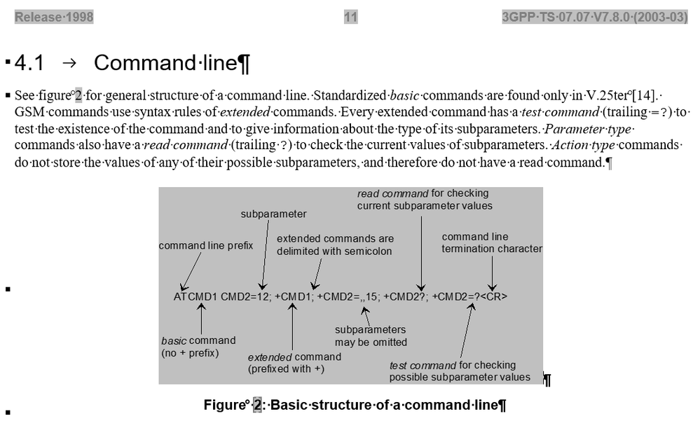

The command terminator is just CR:
https://portal.3gpp.org/desktopmodules/Specifications/SpecificationDetails.aspx?specificationId=323
https://www.itu.int/rec/T-REC-V.250 (supersedes the https://www.itu.int/rec/T-REC-V.25ter referenced in GSM07.07)

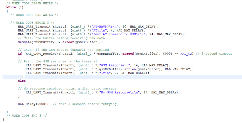

the GSM is still not responding to the AT commands, I sent a simple AT command for which the module is supposed to reply with OK but it is not doing so.
Code:
Is there anything I could be doing wrong? What can i try to do now
I tried to do so, but it's not giving an OK response.

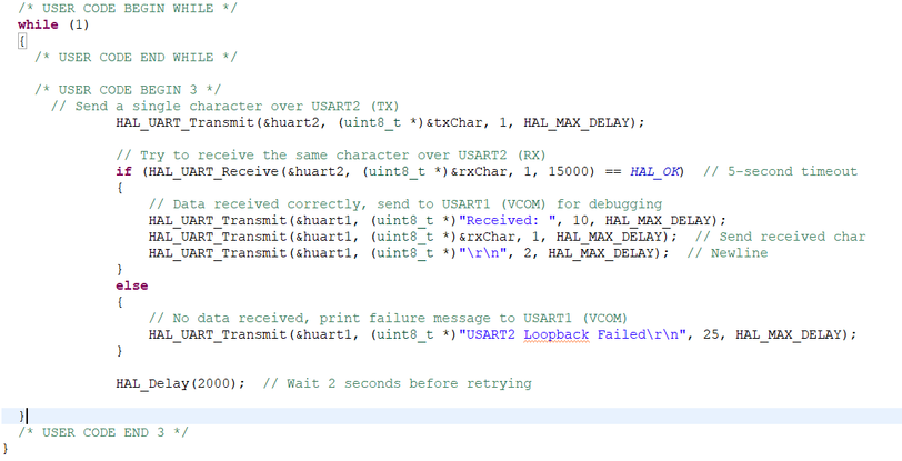

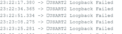

I tried another debugging, I connected PD5(which is the USART2 Tx) to PD6(Rx) directly and tried a loopback test just to see if the channel is working.....it is not, the loopback test itself fails..
so i think the mistake is in the configuration and initialization itself,
but I can not tell what is wrong with the configurations, everything seems to be correct.
