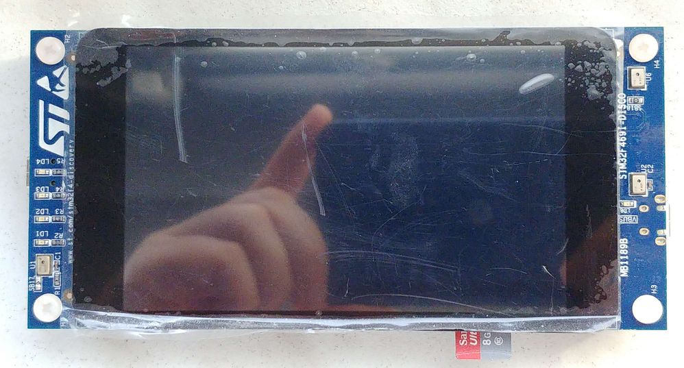

Hello @PGroe.2​ ,
Thanks for pointing out this confusion with the STM32F469-DISCO revisions.
Can you please share the stickers pictures on the boards ?
In this way I can have the batch and revision, and I'll check it out and come back to you with an answer.
Imen
Thanks
Imen
‎2021-06-16 6:27 AM
Sure:

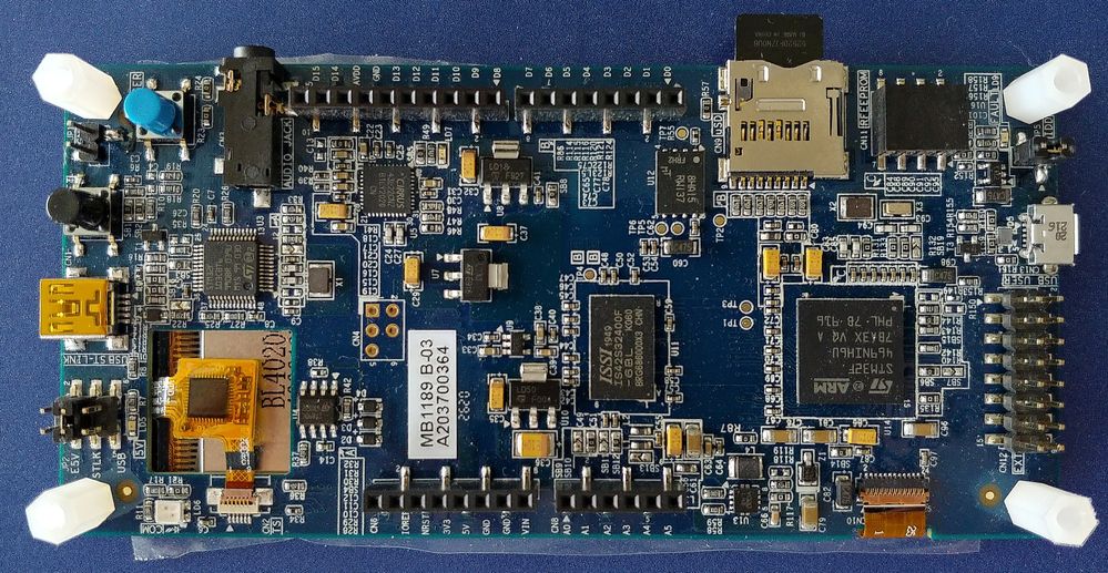

‎2021-06-16 8:37 AM
if possible, can you upload picture of other side as well ?
‎2021-06-16 8:52 AM
Sure:
‎2021-06-16 9:20 AM
So this is a revision B-03 PCB.
Assembled W37 2020.
Please use rev B schematic.
Probably the SDRAM reference has been swapped for availability reason.
