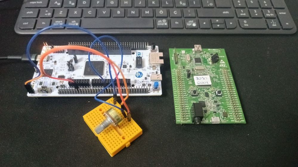

Hello, I’m trying to perform ADC measurements with the STM32H563ZIT. I’ve shared my configuration settings from the .ioc file below. The ADC reading fluctuates by about ±40. When I short the ADC pin to GND, the reading varies between 0 and 30 instead of staying stable. I can’t get a constant value. What could be causing this issue?

Which Discovery board - I don't see an H563 Discovery ?
Showing photos of both setups could help ...
LCE
Principal II
Check the Nucleo's PCB layout and try some other ADC input.
There are many signals going loooong ways to the connectors and other hardware via solder bridges.
If you ground such a "bad" line without a capacitor close to the MCU input, there'll probably be some interference noise from the PCB.
I remove the cables from the nucleo and connect them to the discovery board.
I just got my Nucleo card. I don't think there's a problem.
So that's an STM32F4-Discovery - very different to an STM32H563 !
And, as has been said by many, long wires and breadboards are very prone to picking up interference
How is this setup grounding the pin exactly? Jumper from the pin to GND directly. Looks like it's connected to a potentiometer, not grounded.

I'm getting the ground connection directly from the board. There are no problems with the connections. Long cables don't cause any problems on the Discovery board. I don't think it's the cable either. Do you have any real suggestions for a solution?

Meanwhile, you didn't confirm which discovery you are using: STM32F4-Discoevery or STM32H573I-DK there is is big difference between both: note the same product, not the same architecture, not even the same ADC!
Another hypothesis, it could be due to the Ethernet PHY on the Nucleo board.
Read this article: ADC value affected by ETH PHY 50 MHz from RMII interface
From my side, I tested the following channels:
- CH10 (PC0): worst case 5LSB
- CH3 (PA6): worst case 2LSB
- CH2 (PF11): worst case 2LSB
- CH6 (PF12): worst case 2LSB
So try channels far from ethernet signals. Try for example: CH6 (PF12).
Attached the project I used for my tests. If you are still getting 40LSB, you need to remove all the non needed stuff including the potentiometer that we are seeing in the photo and keep only one wire to ground the ADC. Please use short wire.
