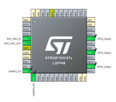

as a first time user of STm32CubeIDE, I wanted to toggle a few IOs with a serial output.
I used the JTAG port to connect to the STM32 and program it BUT after the first programing, I can't connect to it anymore.....
Here is the pinout that I used:
Afterwards, I discovered that I should have activated the JTAG debug.... but it is too late.....
What can I do to access/program the STM32 again?
This might be a simple question but I would appreciate the help.
Thank you
Ced77fr
After some tests and errors, I was able to get the chip back under JTAG control by:
- putting BOOT0 to 3.3V at startup
- using UART1 (through a USB-TTL serial adapter): PA10 (RX1) and PA9 (TX1) to access the chip and reprogram it.
Now, I have the JTAG programing back.
Thanks for the feedback

depends on..what st-link you use/have ?
usually, just connect "under reset" /hardware , then dont forget to set debug -> SWD .
And avoid using the pins needed for debug to abuse for anything else. :)
