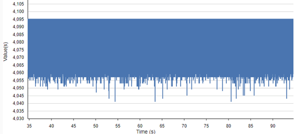

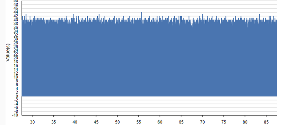

Below is an example of the noise that we observe with ADC on an STM32F7 when ADC is connected to ground and to VDD with 12b resolution respectively. This is induced by the phy clock input of the Ethernet peripheral:
ADC noise connected to GNDADC noise connected to GND
ADC noise connected to VDDADC noise connected to VDD

  • Issue: This configuration leads to additional noise (approximately 10 LSB with peak regions at 500 Hz) on pins 36 (ADC123_IN2) and 37 (ADC123_IN3), despite the presence of an antialiasing filter.
  • Observation: The noise is significantly higher compared to other similar filtered sensor signals, which exhibit around 5 LSB noise.
