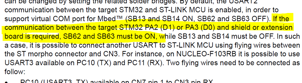

I have been trying to use three pots as dials for a guitar effects pedal project. Their purpose is to simply read the voltage from 0 - 3.3V and with some scaling (to turn the raw readings into 0-100 values) in the code to store these 3 values inside an array of length 3 and also display them in my LCD. I have tried to use one pot per ADC (3 onboard) as well as different channels on the same ADC.
The weird thing is that it works as intended for the first 2 pots but if I add the 3rd one with the same ADC configurations it simply won't read. The value stays oscillating as if the pin was free or grounded.
I am using pins PA0, PA1, and PA2 for ADC1, ADC2, and ADC3 respectively. I am using 3.3V as the input for the pots. Please let me know if anything occurs to you or have had a similar issue in the past!

> STM32 Nucleo-F446RE
In this case, the most likely explanation is that SB63 isn't closed, so D1 isn't connected to PA2.

> STM32 Nucleo-F446RE
AP.10
So it seems that there is no way to use use the ADC3 through D0 or D1 without making hardware changes, correct? Also, I am using the nucleo board to prototype before transferring code to our custom PCB. In the case of the stm32 chip on the PCB, I am thinking this would not be an issue since it looks like this setup is specific to the nucleo board?
Also I should mention I got it to work using pin PC3 on the Nucleo board, which confirms that pins PA2 and PA3 do not seem to be connected to D1 and D0 as you mentioned. So thanks for clarifying that!
