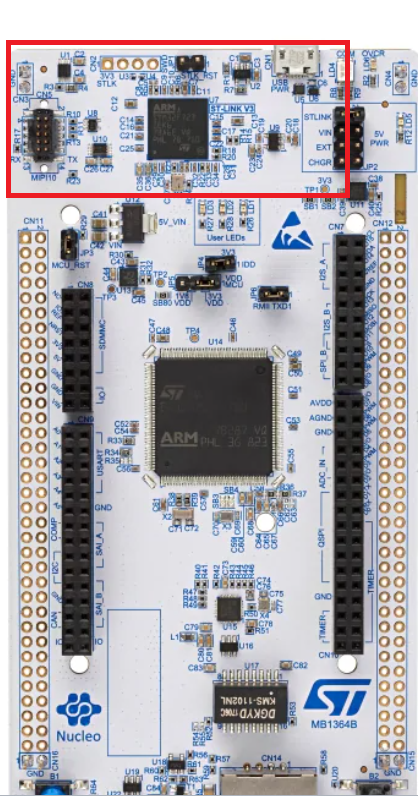

If yes that's not possible (there is no modification available) to use that ST-LINK to program an external MCU target.

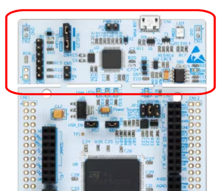

Does your board have the break-off ST-Link V2.1 part - like this:

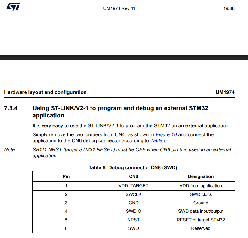

If it does, then this applies:
https://www.st.com/resource/en/user_manual/um1974-stm32-nucleo144-boards-mb1137-stmicroelectronics.pdf#page=20
via: https://www.st.com/en/evaluation-tools/nucleo-h743zi.html#documentation
However, this has  a number of limitation; a standalone ST-Link is not expensive - I would strongly suggest that you get one!

Please provide the link you've purchased the board from so we can check if it feature STLINK V2 or V3.
In fact there are two versions of that board one having STLIONK V2 and one V3.
If V2, it's possible like indicated by @Andrew Neil otherwise (V3), that's not possible as indicated by me in my previous post.

There is always an ST-Link there - the question is whether it's the old ST-Link V2.1 (as I showed) or the new ST-Link V3 (as @mƎALLEm showed).
Only the the old ST-Link V2.1 (the break-off one) can be used to program/debug an external target.
