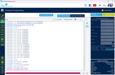

I'm currently developing an external loader on STM32H563ZIT6 development board.
I'm facing an issue on programming with cube programmer in the image below
The problem I think might be linked to interrupt handler of systick.
 I've attached the Loader_src.c file where I had developed the functions used by Cube Programmer; also attached the linker used.
The low level functions linked to XSPI communication are properly working, because I had tested in debug erasing and writing sectors.
I need help to figure out the problem.

Thank you so much @Saket_Om for the guide, I've already copied the git hub repository linked, but the problem is stll present. I had put some debug pins in Init function and it seems that Init is not called. Could you please give me some advices on where to check? Linker error?

I've solved through these changes:
I've added this code in .ld file :
KEEP (*(.text.Init))
KEEP (*(.text.Write))
KEEP (*(.text.Verify))
KEEP (*(.text.Checksum))
KEEP (*(.text.SectorErase))
KEEP (*(.text.MassErase))
I've removed the flag to discard unused sections in project properties.
It seems to work properly with STM32 CUBE programmer, but when I add it in my main project to load data
for TOuchGfx it doesn't erase external sector.
