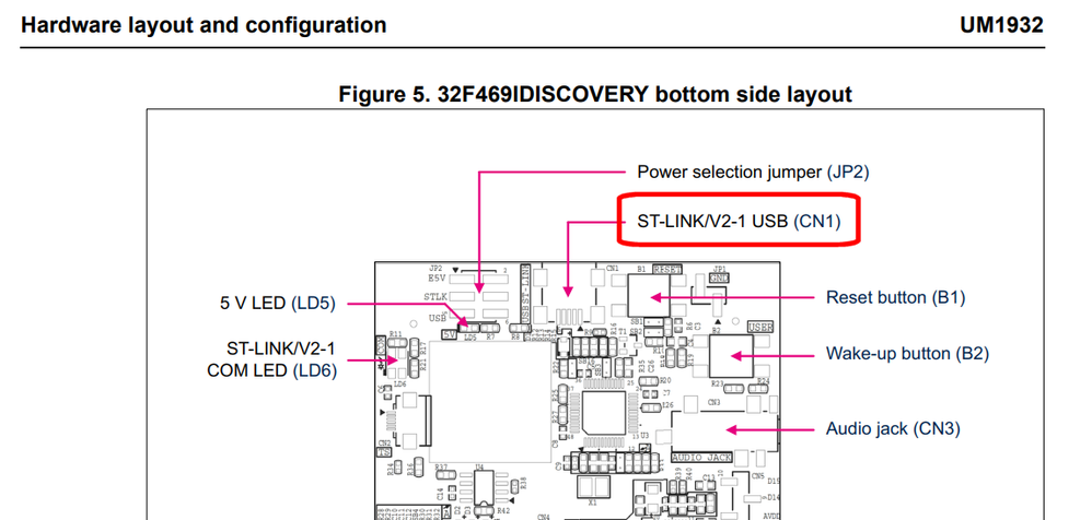

It looks like I have the 32F469IDISCOVERY board that looks to be powered ok via USB connector CN13, however the board doesn't appear to have demo software preloaded. COM LED LD6 flashes red.

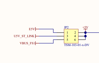

Why are you using CN13 to connect to the board? CN13 is used for USB of the chip.
If you need to power the board with USB, you need to close JP2 on 3-4 position.
And you need to connect to CN1 over ST-LINK to connect to the board.

For programming and/or debugging, use the built-in ST-Link on CN1:

I am powering via CN13 with jumper JP2 in the correct position. I have done this to ensure that adequate power is provided to the board in all circumstances, such as during initial USB enumeration.
You could try to power the board from the mentioned CN6 input (6..9V).
The default USB current limit is 100mA, the higher 500mA supply must be "negotiated" by the driver after registtration. You can run into trouble when the board draws more than that during this phase. I had such issues occasionally with boards that had a LCD screen.
Another option would be to prevent the target application from starting up (and initializing the screen), e.g. by setting a BOOT0 jumper.
If the ST-Link comes up in this configuration, you probably have a supply issue.
Some PCs (and USB ports) might be more tolerant than others in such cases, by the way.
