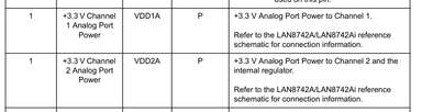

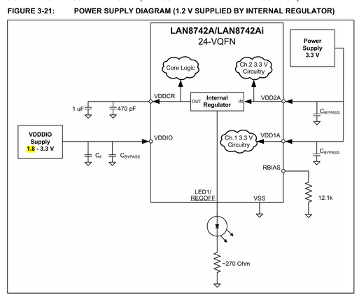

No.
The LAN8724 chip needs 3.3 V on VDD1A and VDD2A. It is not guaranteed to work if these are 1.8 V. Since the boards connects these pins to VDD, it won't work when VDD is only 1.8 V.
