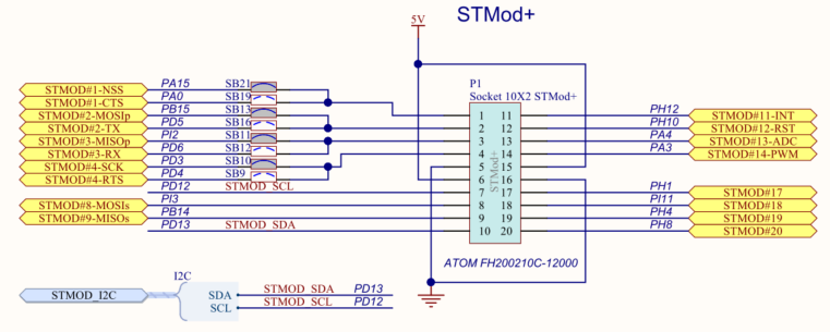

I'd kindly ask for some help on determining exactly which MCU pin is connected to STMod+ extension board.
Which pins exactly are connected to STMod+ pins 2 and 3 ?
It seems like two choices for both pins, but I'm not sure how to check/modify which comes to STMod+ connector?
I guess from schematic that PI2 amd PB15 are connected to pins 2 NS 3, but that would mean that I don't have
USART device on STMod+ connector ?
Thanks in advance,
regards.

According to the STM32H750 datasheet:
USART1_RX is available on PB15 (by default).
On PI2 there is no UART/USART available.
Alternative by using USART2 on the following GPIOs:
PD5: USART2_TX
PD6: USART2_RX
Achieved by removing SB13 (PB15) and soldering SB16 (PD5) and by removing SB11 (PI2) and soldering SB12 (PD6).
Hope it does answer your question.

->By default: SB is soldered
-> By default: SB not soldered
So here you can deduct which pin is connected and which is not.
By default: PB15 is connected to P1/2 and PI2 is connected to P1/3

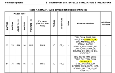

maybe I'm wrong, but it seems that we can get USART1 TX and RX instead of SPI2 interface.
I'm attaching my sketches.
Regards.
According to the connector sketch you shared only USART1_RX is available on PB15. USART1_Tx is not available.
You need toc check the avalable alternate fuction in the datasheet: Table 7. STM32H750xB pin/ball definition
So you need to modify the board as I described above to use USART2

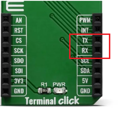

I meant PB14...So if you don't need SPI2 MISO, then you get USART rx, tx interface... But I guess clickboards with UART will have uart pins on RX,TX... So partial solution, but it is...
Regards.
Yes but does it fit with the module connections (already hardwired to CN10/2&3)? That's the question.. unless you will introduce a modification on the module which you avoid to do it (as you said before).
Unless I'm missing something...
