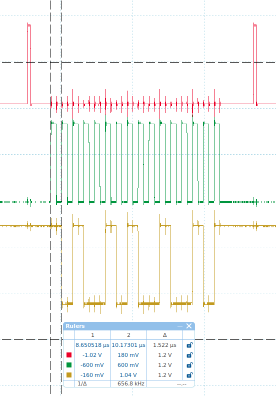

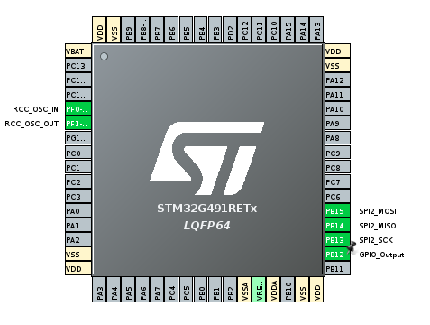

Please find the captured signal
Signal definition:
SignalPurpose
RedNSS (Controlled manually)
GreenSCK
BrownMOSI
The captured signal is wrong. The first data bit from the left should be 0 but is 1. In mode 1 raising edge of the SCK should alter the data bit and in falling edge should latch it.

As we closely observe the data being sent is byte swapped. So swapping bytes while sending and after receiving solved the problem.
But not clear why it is sending 0xA5 first followed by 0x25 although it is configured to send MSB first.
Can anyone help me to understand this? Thank you.
STM32 is little endian, that means that in memory, tx_data is stored as this:
AdressContent
rx_data0xA5
rx_data + 10x25
When you call HAL_SPI_TransmitReceive with rx_data address, it send first content of rx_data, then content of rx_data + 1, so 0xA5, then 0x25.

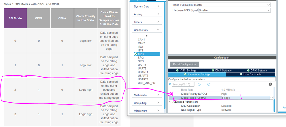

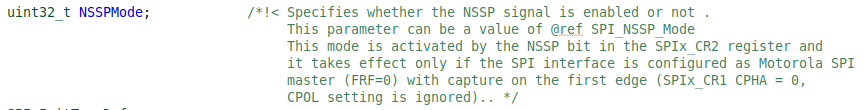

It is mentioned in the stm32g4xx_hal_spi.h that SPI_NSS signal will be enabled only if CPHA = 0. But in my case, it is 1. So why can't NSS isn't going to work in this case?
Hello @newbie_stm32 ,

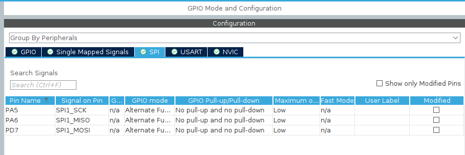

Can you please share the SPI settings you set for mode1 (CPOL=0;CPHA=1). I'm not able to identify the issue because of which I'm not able to communicate with SPI slave.
I'm using STM32H723 with a SPI slave AD5293 (digital pot). AD5293 follows SPI protocol with CPOL=0;CPHA=1. Here is the screenshot of my SPI settings in CubeMX.
Note: I referenced the settings from another answer from STM forum where I found the following image -

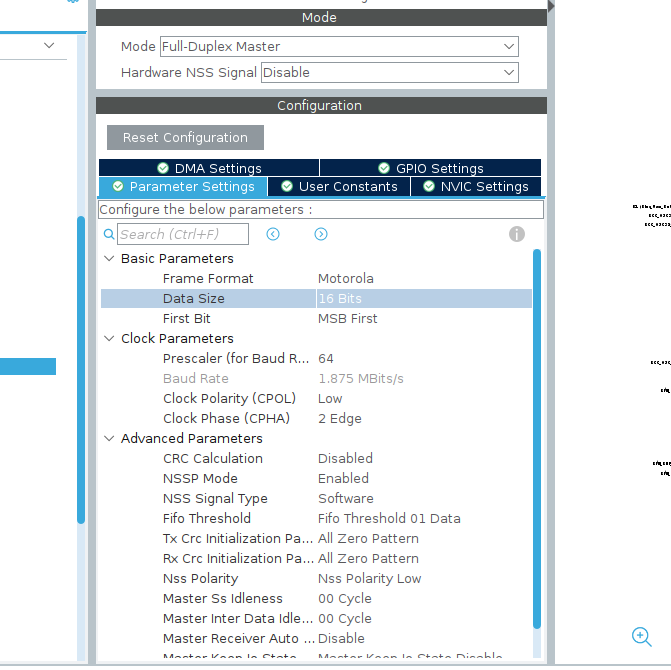

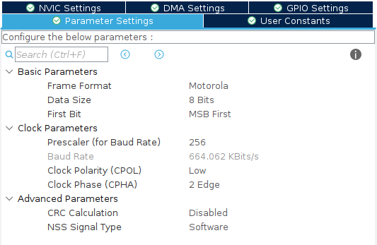

Hi @bruce_wayne_1997 the following configuration worked well for me with AD5592 SPI on CubeMX.
Data Size8 Bits
CPOLLOW
CPHA2 Edge
Use HAL_SPI_TransmitReceive and probe the SPI on the oscilloscope/analyzer.
In my case, as the data sent to AD5592 is 16 bits in MSB first order, STM32 sends the MSB of the first byte 0x02 (rather than 0x18) in your case a swap between bytes is needed.
I hope this helps!!!

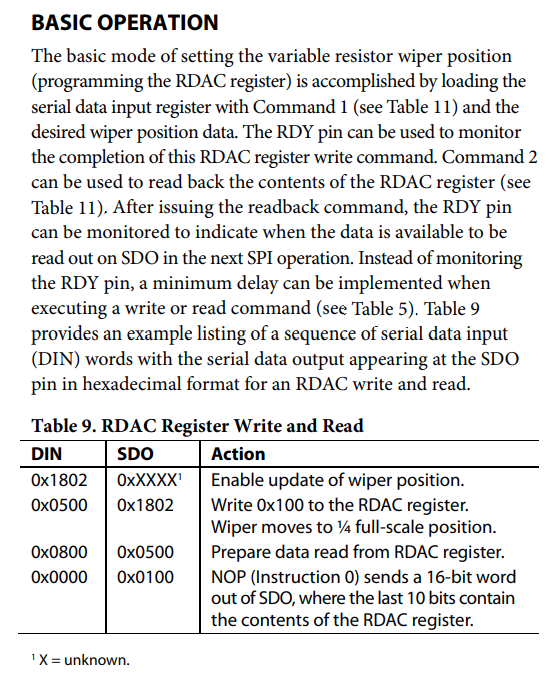

Hi @bruce_wayne_1997, can you run a debug session on STM32CubeIDE and check for the following?
As per basic operation
  1. Send 0x1802 on SPI using HAL_SPI_Transmit (You are doing it correctly)
  2. Send 0x0500 using HAL_SPI_TransmitReceive and check you received 0x1802 (As per Table 9)
PS: Consider swapping bytes

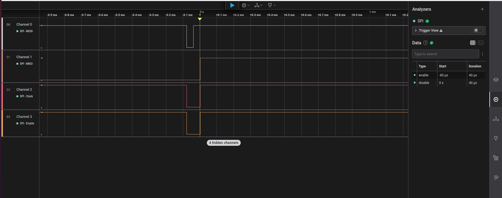

bruce_wayne_1997
Hello @newbie_stm32

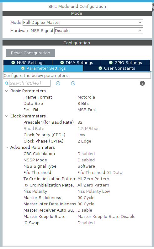

I have followed your suggestions on changed I need to make to transfer the data to AD5293 chip.
First I'd like to share my SPI configuration again: (Figure 1)

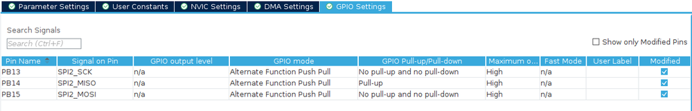

Sharing the SPI GPIO config: (Figure 2)

 I'm not able to receive anything on spi_rx_buf[2]. I concluded this using debug mode after line 27 from the code above. I believe this is happening because my SPI on the STM is not working properly - the SCLK line.
Sharing the Oscilloscope data: (oscilloscope is 24MHz, 8ch): (Figure 3)
 As you can see, the clock line is only changing once, the SPI data is not being transferred to the slave.
Sharing the SPI initialization code generated by Device configurator: (Code 2)
SPI Config: SPI Mode 1 (CPOL=0;CPHA=1), 8 bits, MSB first

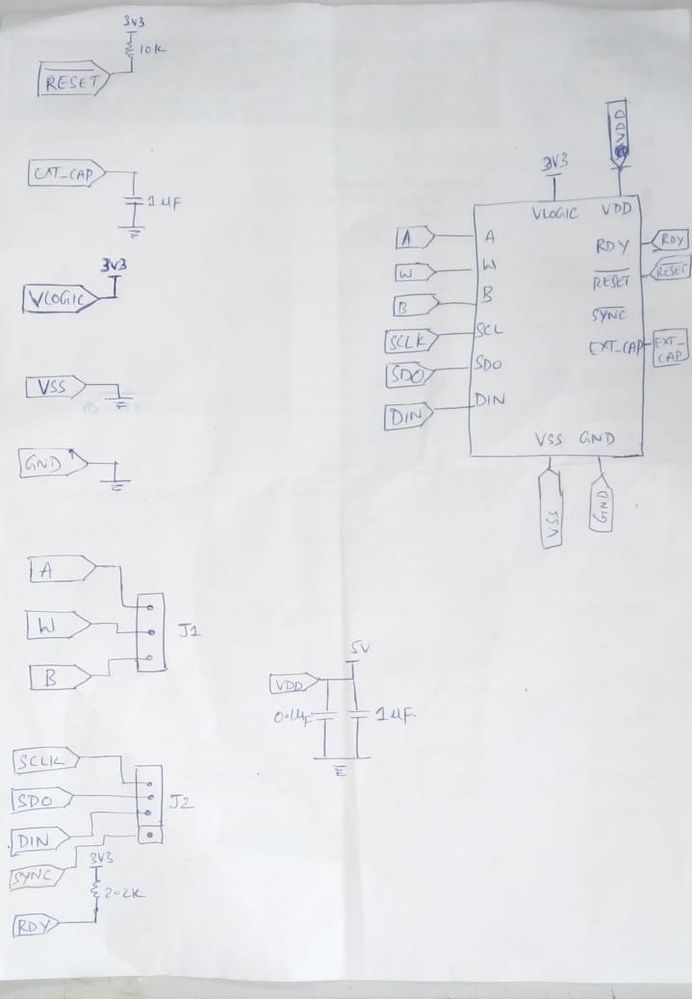

Although the slave is not the problem I'd like to share the schematics of AD5293 circuit I made for more clarity.
Is this correct?
