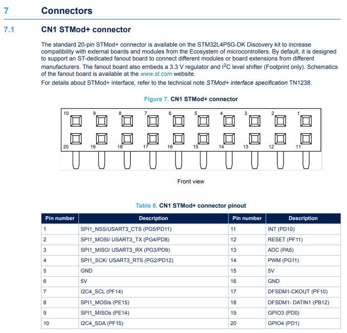

As far as hardware configuration goes, I'm already using the I2C4 bus on the STMod+ Fan-Out Expansion Board, so I'm assuming the STMod+ (CN1) connector is enabled. Is this a good assumption, or is there a jumper on the board that needs to be configured to "fully activate" the STMod+ connector?
As far as I can see, all signs are go. I need help determining how my firmware or hardware is misconfigured.

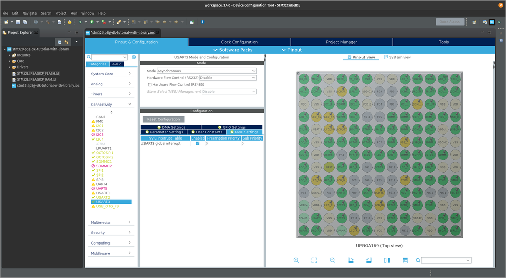

Here is the Device Configuration Tool view:
0693W000005Ag24QAC.pngPinout from the User Manual:

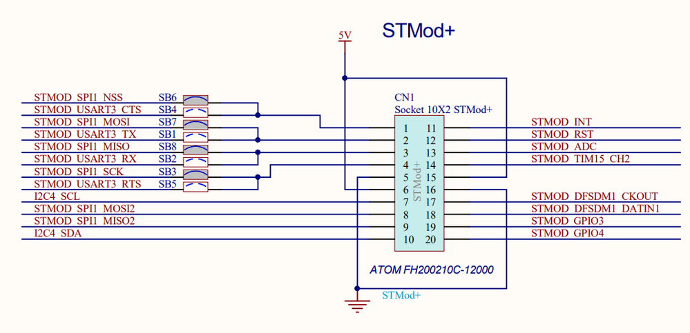

Did you close the necessary solder bridges?

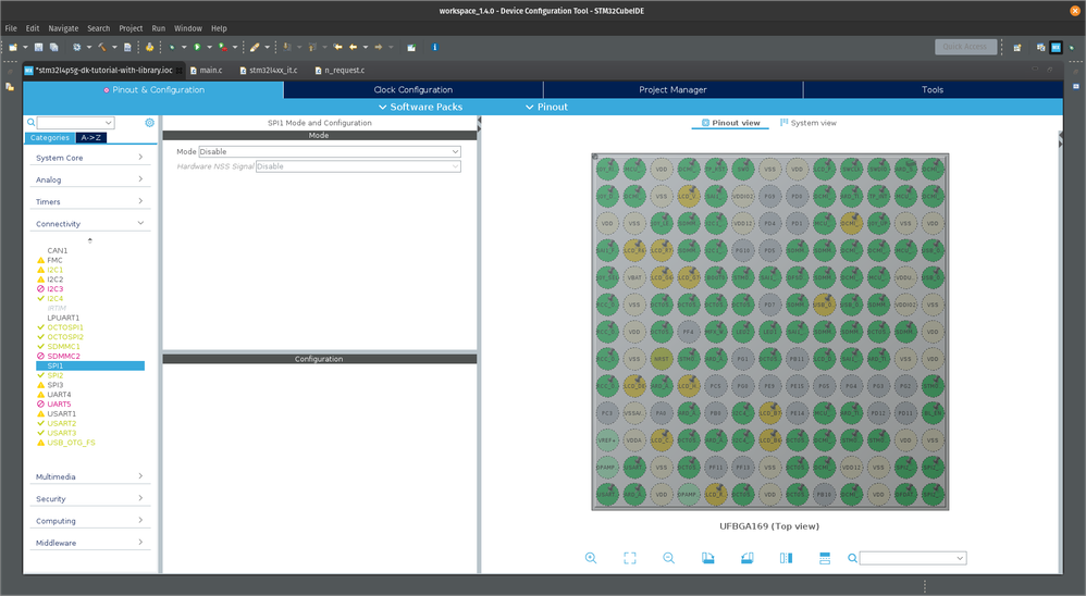

Also seems like you still have SPI1 in use, which will fight for the same pins as USART3, unless you've changed them.

I was unaware of the solder bridges, so I'm sure that is a problem. Where are they located on the STM32L4P5G-DK? Also, what documentation are you referencing? I would like to learn how I could have found that on my own.

I'll hunt for the solder bridges, but if you're up for it, I would still appreciate a pointer. In the meanwhile, I've attached my NEW pin configuration, in case you can see any other obvious problems.

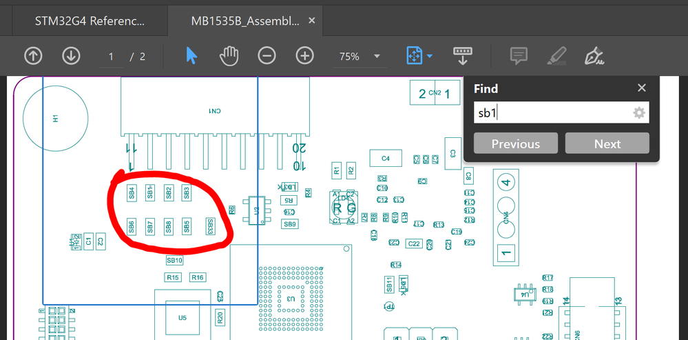

The bridge should be labeled on the board. Might take a minute but just looking for it is probably the easiest way. If you get really desperate, you can download the board manufacturing files and Ctrl+F for it.
The schematic and other stuff are available under documentation on the product page. There is also a user manual, although it didn’t mention the solder bridges at all as far as I could see.
https://www.st.com/en/evaluation-tools/stm32l4p5g-dk.html#documentation
> Finally, why doesn't the STMCubeIDE report the pin conflict?
CubeMX has no idea the pins are tied together (via solder bridges) on the board, so it doesn’t know there’s a problem to report.
