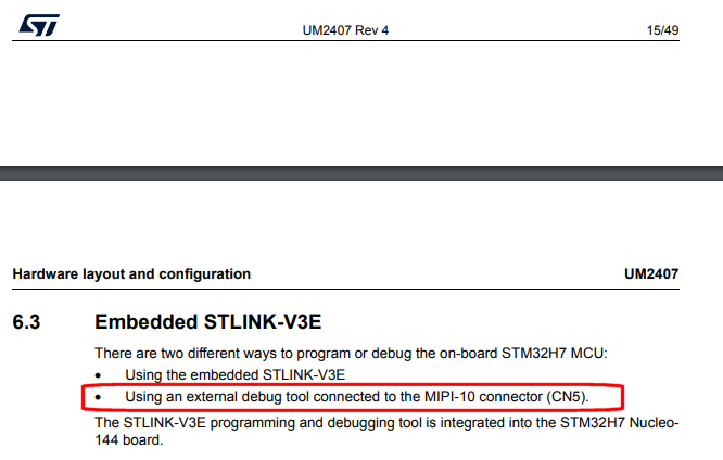

It's just a matter of connecting the external debugger to the Target microcontroller's debug pins - in exactly the same way that the onboard ST-Link is connected to the Target.
Look at the Nucleo board's Schematics to see how the onboard ST-Link is connected to the Target.
You will need to break the connections from the onboard ST-Link in order for an external debugger to work.
There will be jumper links and/or solder bridges to do that - see the Nucleo board's Schematics and/or User Manual for details.

In STM32H7 Nucleo-144 boards (MB1364) User Manual:
See: https://www.st.com/en/evaluation-tools/nucleo-h743zi.html#documentation
So follow the instructions there!

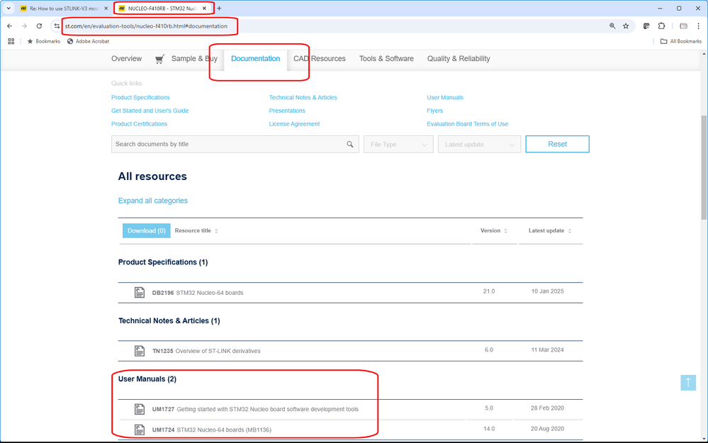

 The user manual can be found on this page, it covers everything you need to know.
https://www.st.com/en/development-tools/stlink-v3set.html#documentation

Again, documentation is on the Product Pages; eg,
https://www.st.com/en/evaluation-tools/nucleo-f410rb.html#documentation

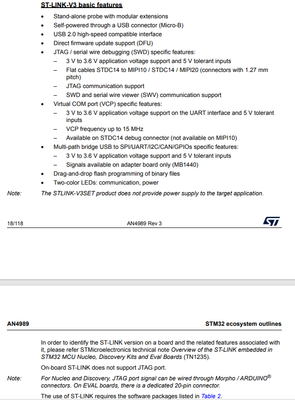

+ AN4989: STM32 microcontroller debug toolbox - Application note
