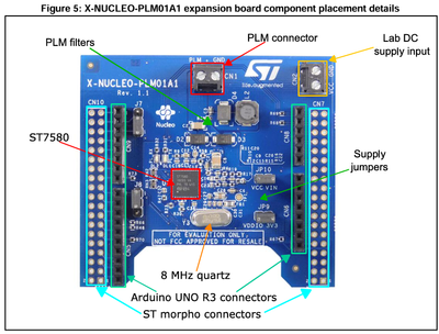

I'm interested in Power Line Communication and the X-NUCLEO-PLM01A1.
I would like to confirm before purchasing.
What is the role of the PLM connector (CN1)?
Is it a PLC line?
If so, is the Lab DC Supply Inout Connector (CN2) just a power supply?
The PLM Connector appears to be a Power Amplifier Output. Does this Connector use a PLC Line?

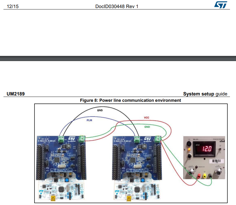

To connect two or more boards, you need to connect the PLM Connector (CN1) to each other.
What is the role of CN1?
Will it be a problem if I don't connect the CN1s to each other?

See the User Manual:  it's where you make the PLM connection - it is the comms link between the two boards:
https://www.st.com/resource/en/user_manual/um2189-getting-started-with-the-xcubeplm1-power-line-communication-software-expansion-for-stm32cube-stmicroelectronics.pdf#page=13
via: https://www.st.com/en/ecosystems/x-nucleo-plm01a1.html#documentation
