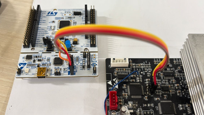

Hello AScha,
Here I've added Screenshot of PCB schematic and Nucleo-Board schematic also and along with that I added physical connection snap .
ok, so the target board is the big board in pic ?
But your circuit shows just F103 , even without crystal ?

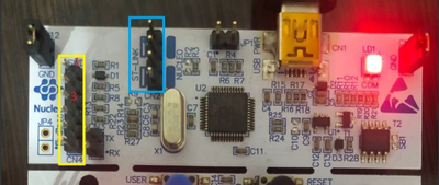

You seem to be using the wrong connector on the Nucleo board:
Rather than those jumpers (blue in the picture below), you should be connecting to CN4 (yellow):
