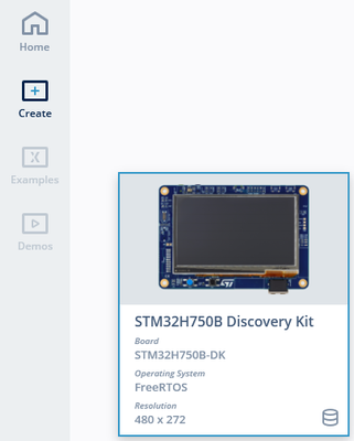

Hello @SivaVishnu09.
Could you try this procedure instead:
  1. Open TouchGFX Designer.
  2. Go to the 'Create' tab.
  3. Select the STM32H750B Discovery Kit TBS.
  4. Press the 'Create' button in bottom-right corner.
  5. Create a simple GUI (or import one).
  6. Press the 'Run Target' button (F6).
Best regards,
Johan

JohanAstrup
Thank you for providing the log. It appears to be correct.
Is this a recently ordered board? Could I get you to verify the board version, which is located below the display. For reference, the board I have here is called DK32H750$AT1.
Best regards,
Johan

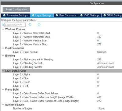

Could I get you to try and insert a box instead of an image?
If this does also not work, try changing the default layer color in the LTDC tab in STM32CubeMX, generate code, and flash the board again. This should help to verify throughput to the display. Also set the Window Horizontal Stop to e.g. 240. Otherwise TouchGFX's background box will overwrite the default layer color.
Best regards,
